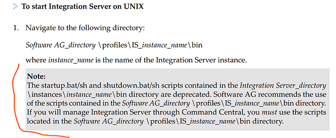

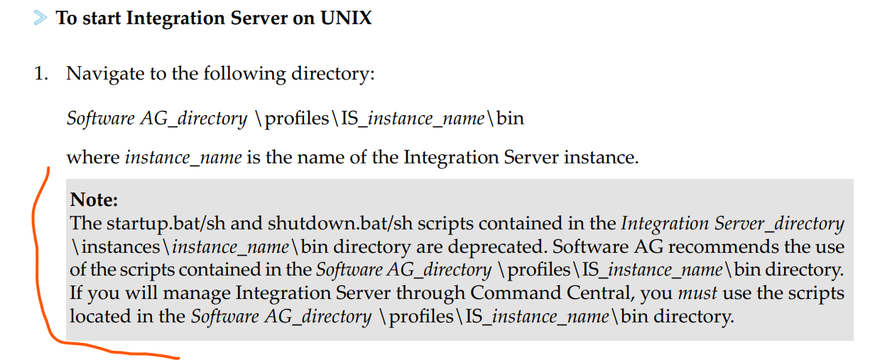

    @Sandeep_Deepala You should use the scripts in /profiles/instance_name/bin/ to start/stop the server. It is recommended by Software AG. The start/stop scripts contained in \instances\instance_name\bin are deprecated. Even if it works, you should not use it.
    Check the section Starting and Stopping the Server of documentation Integration_Server_Administrators_Guide.
