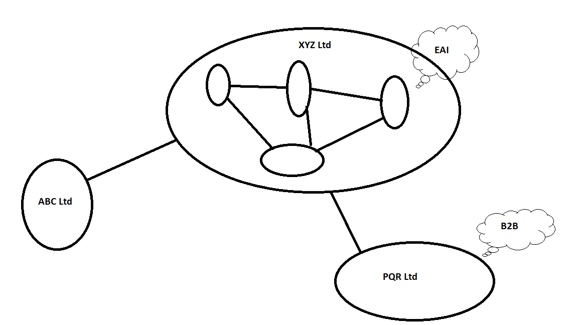

  • 11.  RE: What is the difference between Enterprise integrationEAI and B2B integration
    Posted Thu September 18, 2014 08:45 AM
    Hi
    As of my knowledge
    EAI → When you want to communicate with any application in one company (XYZ Ltd), that time you go with EAI
    B2B → When the company (XYZ Ltd) want to communicate with other company(ABC Ltd), that time you go with B2B
