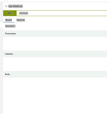

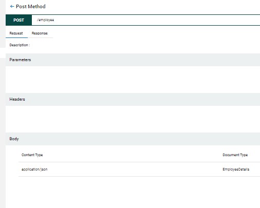

    I tried creating the connector as you mentioned and defined input for only POST and not for GET.
    I don’t see the issue what you are facing. GET method doesn’t have any body being shown in the connector. PostMethod GetMethod
    Please re-create the connector and see.
