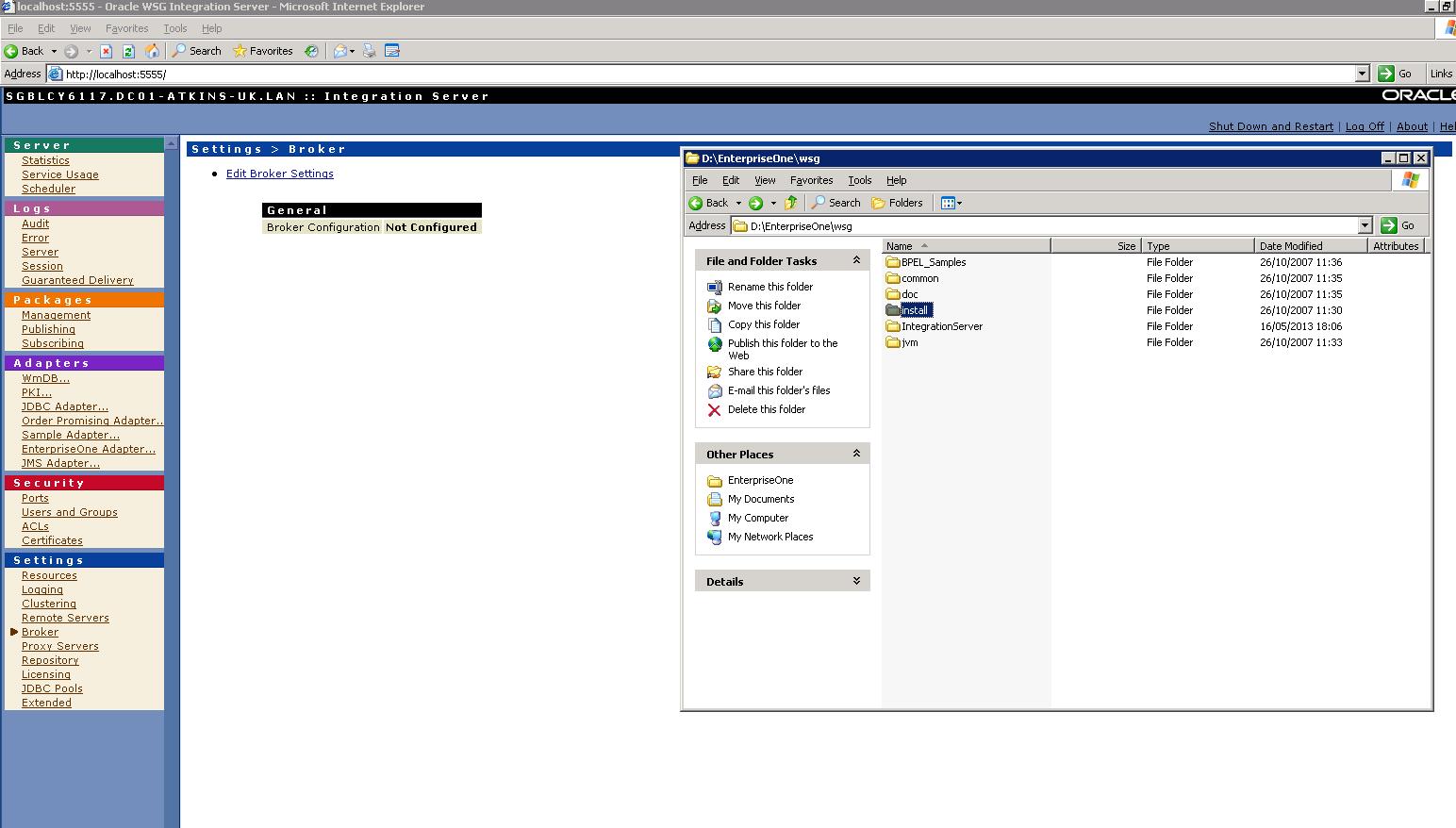

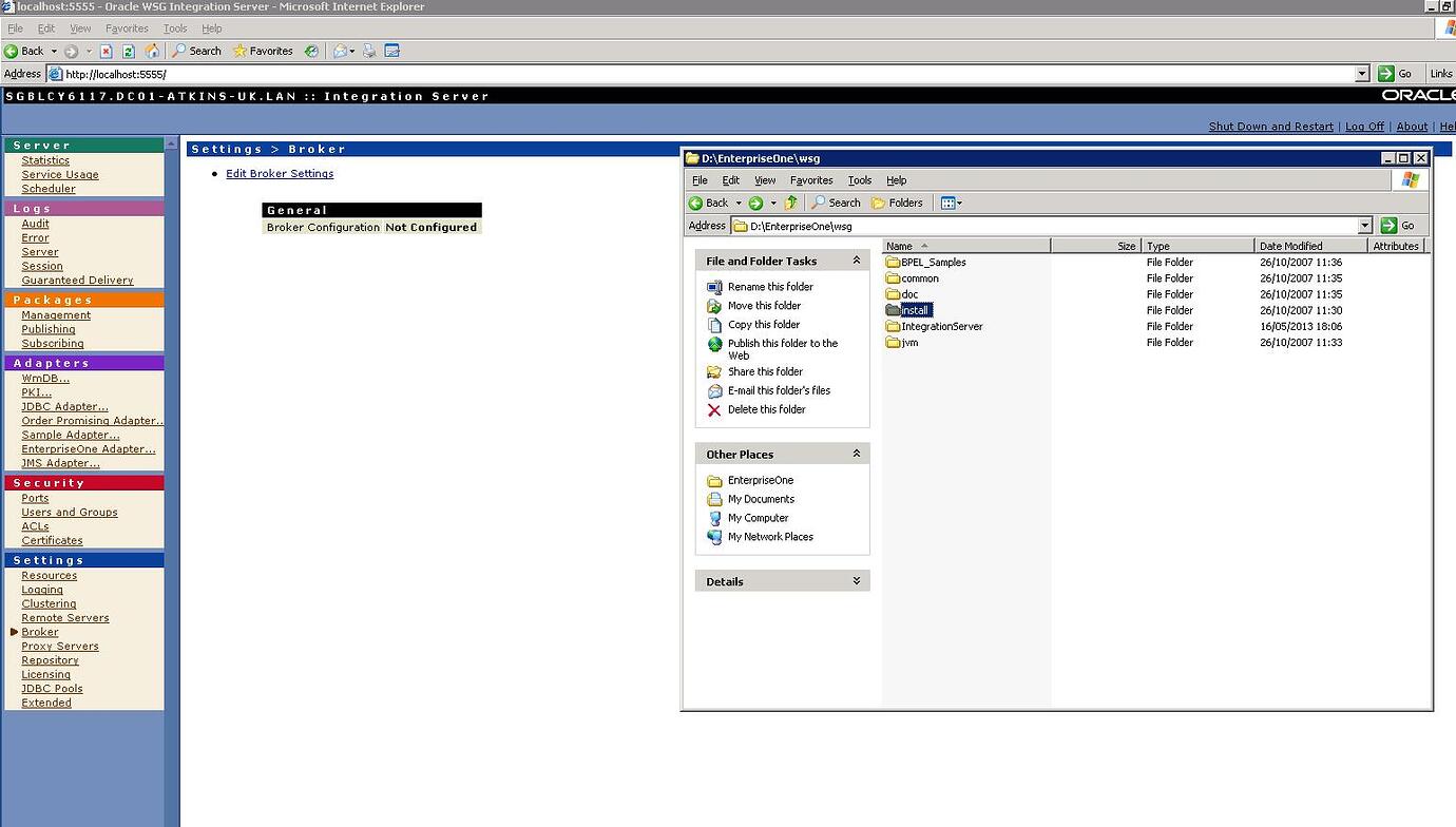

  • 16.  RE: webMethods Integration Server 6.1
    Posted Thu May 16, 2013 02:59 PM

  • 18.  RE: webMethods Integration Server 6.1
    Posted Thu May 16, 2013 03:04 PM
    The error indicates the broker is on “localhost”
    Try to find Broker dir next to your IS dir.
    see if you can find any log for broker
    Is it possible that broker was running command line, not service?
    #webMethods-General

  • 19.  RE: webMethods Integration Server 6.1
    Posted Thu May 16, 2013 03:06 PM
  • 20.  RE: webMethods Integration Server 6.1
    Posted Thu May 16, 2013 03:07 PM
    one step back, do you even use broker?
    from the first a few lines in your log, services are working fine.
    This may be all you need.
    Check the other systems that are connecting/interacting with your WM instance, see any issue.
