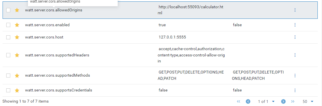

  • 5.  RE: webMethods CORS Error
    Posted Mon February 26, 2024 07:34 AM
    Still getting the same error
    Access to fetch at ‘http://localhost:5555/restv2/calculator’ from origin ‘http://localhost:55093’ has been blocked by CORS policy: Response to preflight request doesn’t pass access control check: No ‘Access-Control-Allow-Origin’ header is present on the requested resource. If an opaque response serves your needs, set the request’s mode to ‘no-cors’ to fetch the resource with CORS disabled

  • 6.  RE: webMethods CORS Error
    Posted Mon February 26, 2024 08:10 AM
    Update your actual watt.server.cors.allowedOrigins parameters with this one:
    watt.server.cors.allowedOrigins=http://127.0.0.1:55093
    To be mentioned:
    • In your first post the caller script is available at 127.0.0.1 with the port 50683 but in the configuration you’ve mentioned the port 55093. Important to mention the right port in the above parameter.
    • Restart your Integration Server after the update.
    If there is a error, give us the error details you get in your browser console.
    By curiosity, what is the server that serve the frontend part ? (Tomcat, HTTP Server, etc.)
