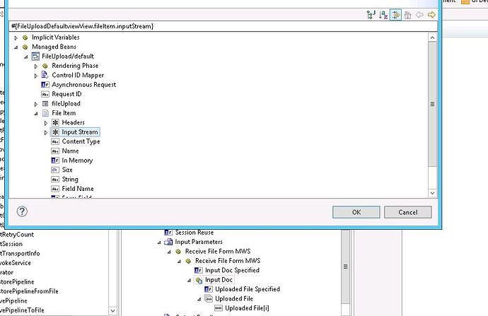

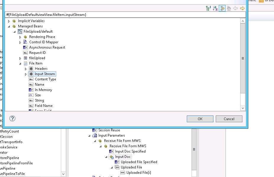

  • 9.  RE: webMethods 9.9 file upload issue
    Posted 05/21/16 06:00 PM
    Hi Manoj,
    I have bind the #{FileUploadDefaultviewView.fileItem.inputStream} to input service doc array.
    please refer attached screenshot.
    #MWS-CAF-Task-Engine
    #webMethods-BPMS
    #webMethods
  • 10.  RE: webMethods 9.9 file upload issue
    Posted 05/22/16 02:15 AM
    Virendra,
    create an new action at the binding.
    And map the file item to the input which suppose to hold the fileContent for service as:
    public String uploadAction() {
    // TODO: implement java method
    getTestUploadFile().getParameters().getTestUploadFile().getTestUploadFile().setFileContent(getFileItem().get());
    return null;
    you can directly map other inputs to the service from binding.
    refresh the service from Upload Action method and map the action with async command or command button on UI.
    getTestUploadFile().refresh();
    return null;

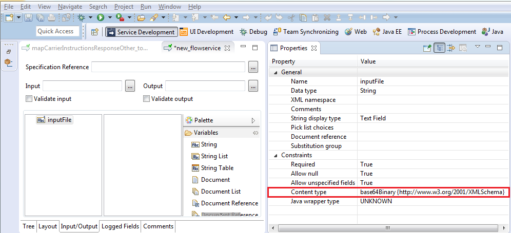

    Hi all,
    changing the wrapper type from UNKNOWN to byte[] works but is probably not a practicable solution. It changes the WSDL as follows:
    <xsd:element name="uploadFile" nillable="true" type="xsd:anyType"/>
    <xsd:element maxOccurs="unbounded" name="uploadFile" nillable="true" type="xsd:byte"/>
    That means that every byte of the file is uploaded with an enclosing XML tag. This is a huge overhead.
    The better solution is to use a String with Content type base64Binary:
    <xsd:element name="uploadFile" nillable="true" type="xsd:base64Binary"/>
    The client stub will generate an interface using a javax.activation.DataHandler:
    getPublishMessage().getParameters().getPublishMessage().getPublishMessage().setMsgFile(new DataHandler(getFile().get(),"application/octet-stream"));
    Now the file is sent as a Base64 encoded string.

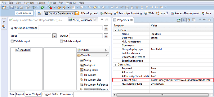

  • 22.  RE: webMethods 9.9 file upload issue
    Posted 11/03/16 07:40 AM
    Hello Stenly Ristau,
    First Create a IS flow service which will receive the file from CAF as shown in the image below.
    #webMethods-BPMS
    #webMethods
  • 23.  RE: webMethods 9.9 file upload issue
    Posted 11/04/16 04:55 PM
    Hello Manoj, thank you for the help. I got it now:
    public String uploadCommand() {
    getUpload().getParameters().getUpload().getUpload().setInputeFile(new DataHandler(getFileItem().get(),“application/octet-stream”));
    getUpload().refresh();
    return null;
