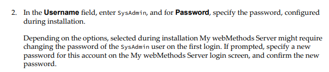

Please check page 14 here:
Starting 10.11 only sysadmin is enabled by default and it uses the password provided during the installation.
Hello,

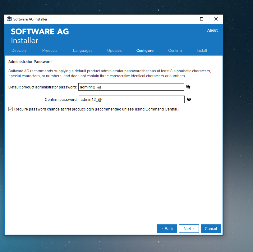

I tried that as well, but seems it did not work for me Please find the below steps, let me know if I have done anything wrong.
Installed SAG
Ran dbConfigurator and configure IS and MWS with 2 different users username: webmisx11 [for IS] username: webmmwsx11 [for MWS]

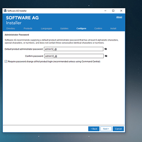

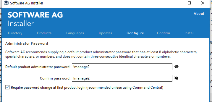

At the time of installation, i had selected the default admin password (attached picture)
Tried to login with following combination a. username: webmisx11; password: <provided during the time of dbConfigurator] b. username: webmisx11; password: admin12_@ c. username: sysadmin; password: admin12_@ d. username: sysadmin; password: manage

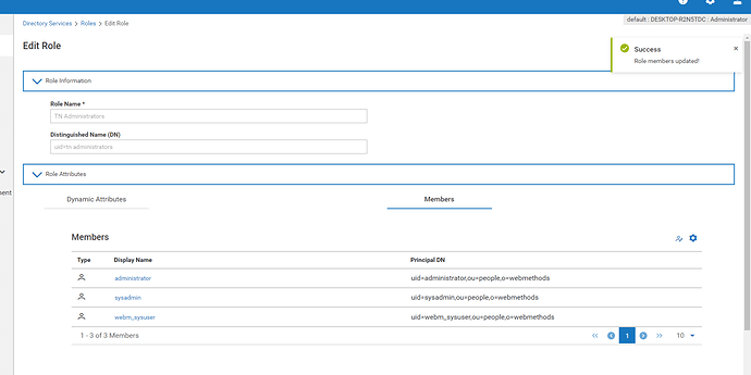

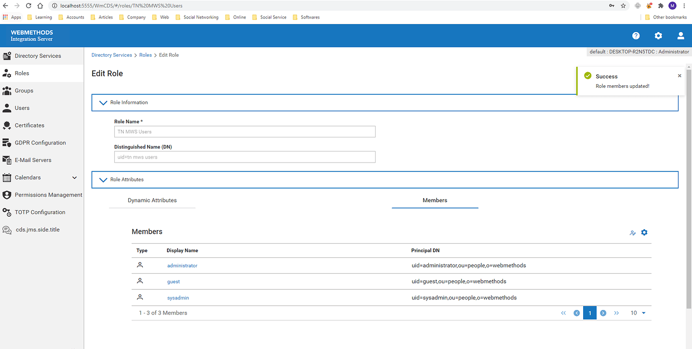

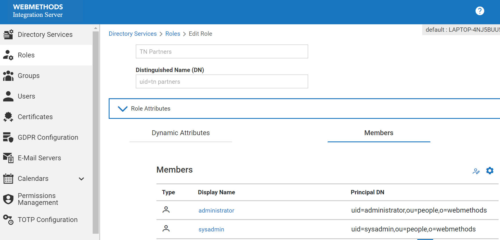

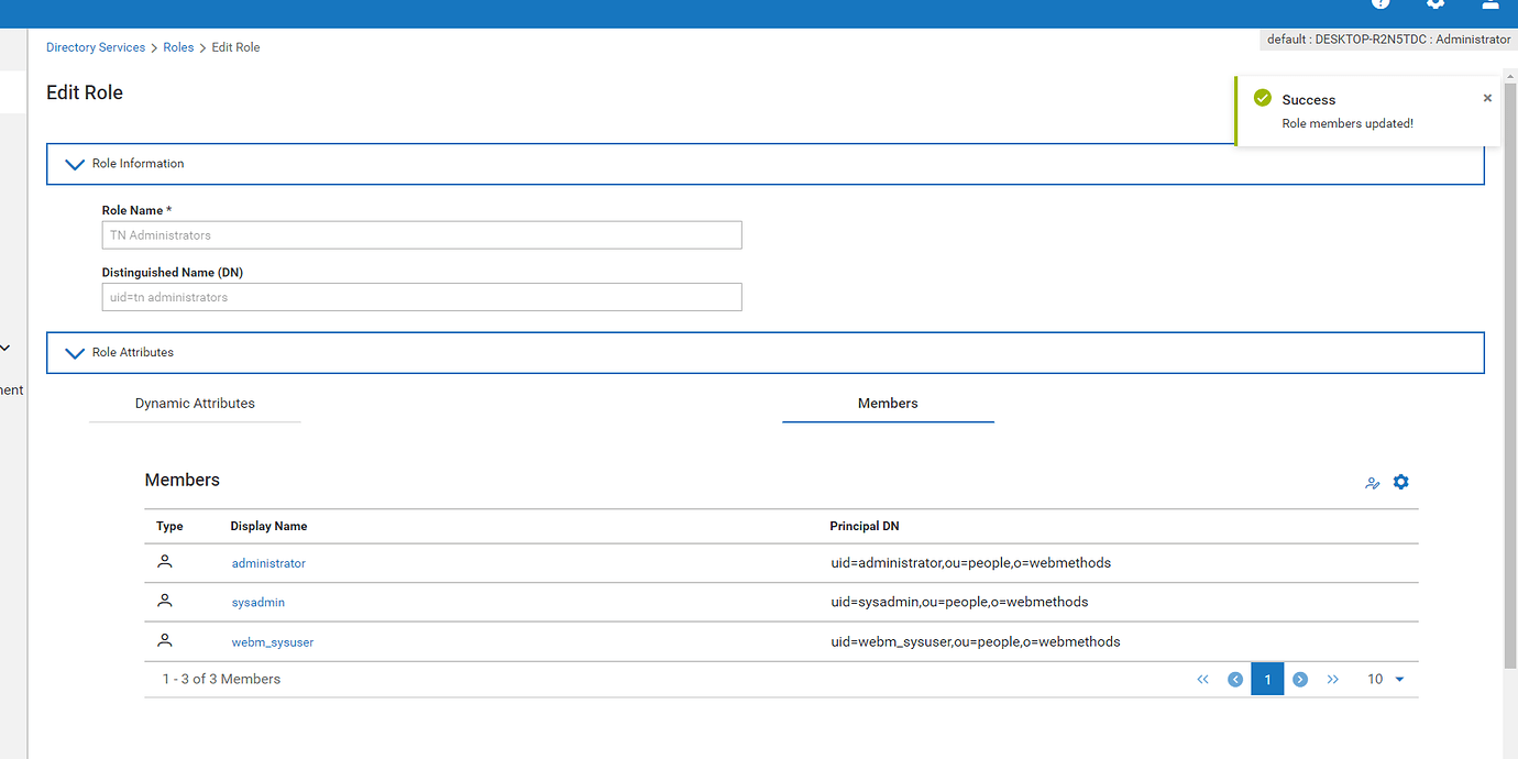

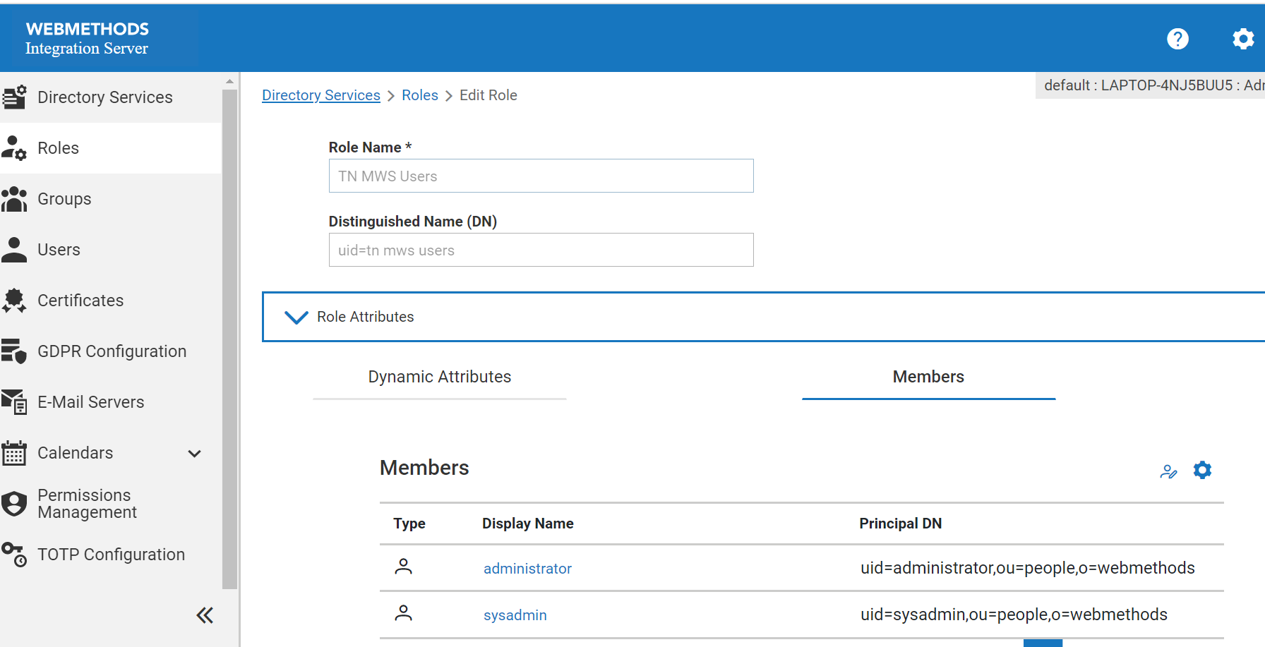

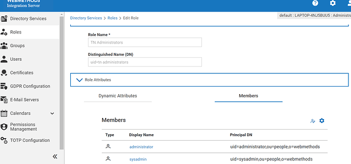

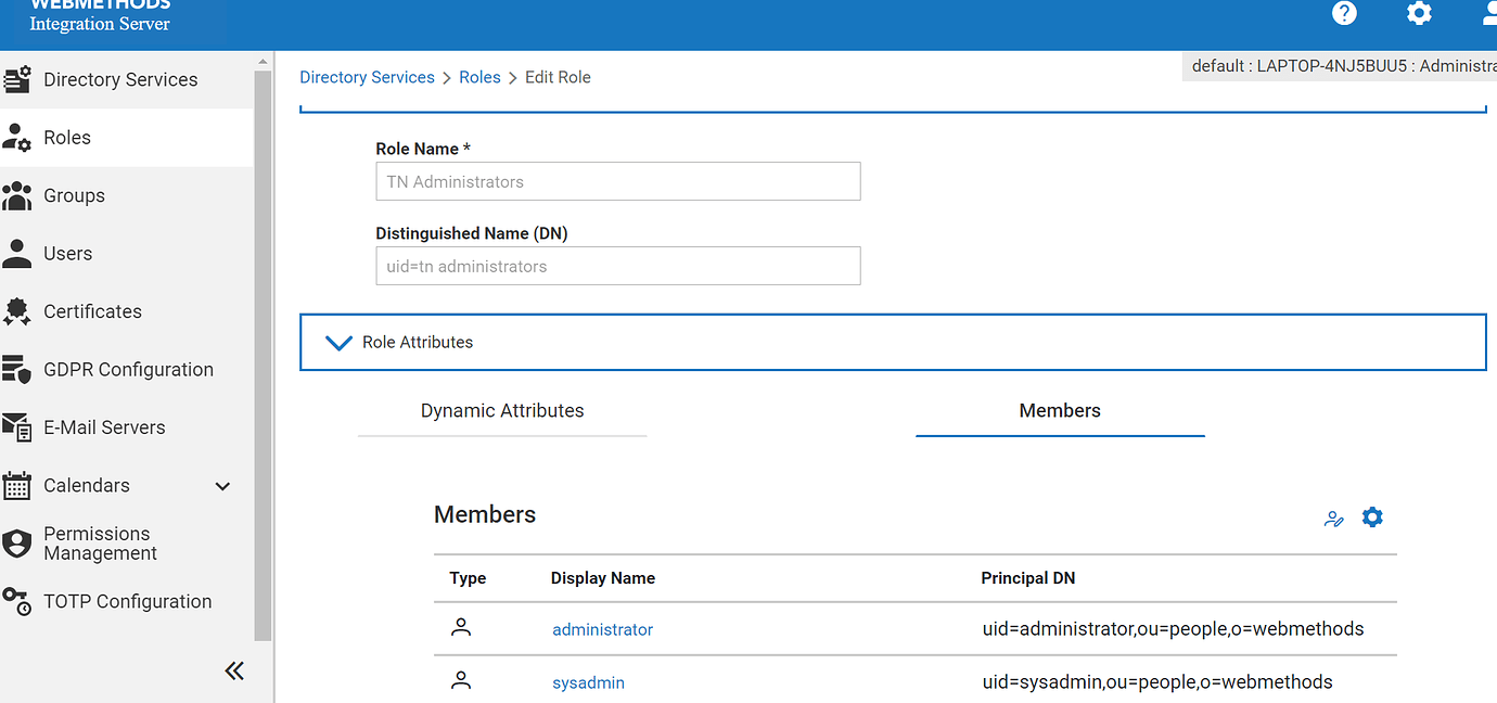

Hi Kaushik,

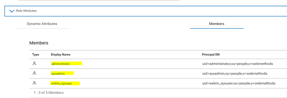

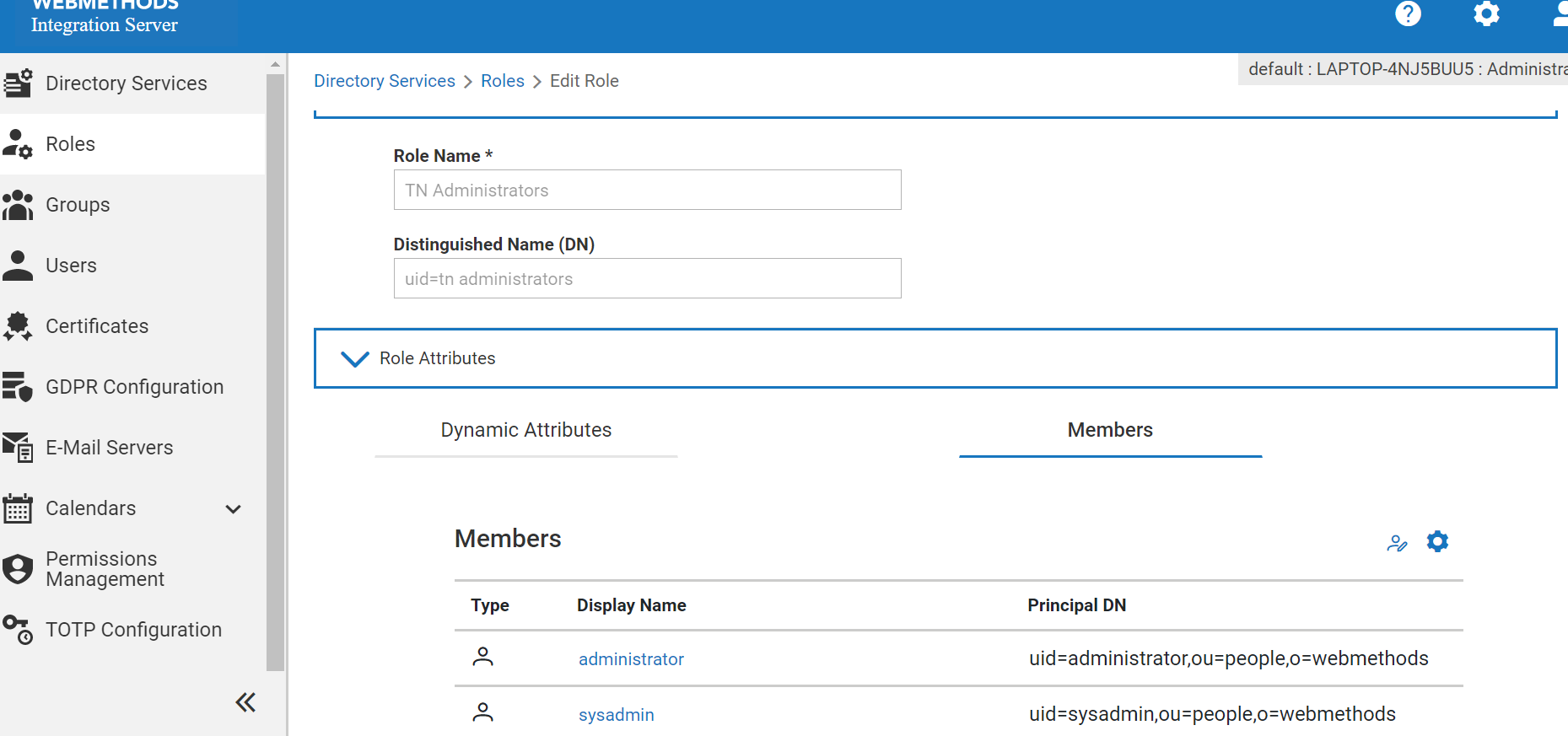

are you able to login into IS? If yes, can try to check whether the TNMWSUsers and TNAdministrators ACL have the correct associations? If no, then can try to add the local/Administrators into the groups, and login again MWS.
Hope this help, thanks
Brilliant, thanks a lot Alex, it worked

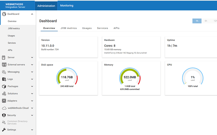

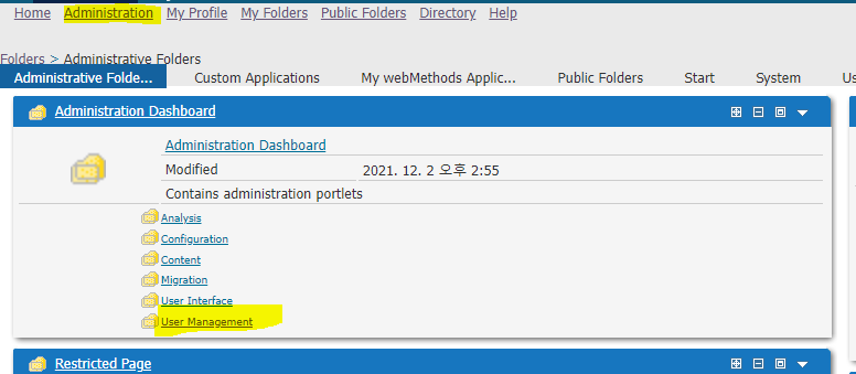

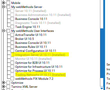

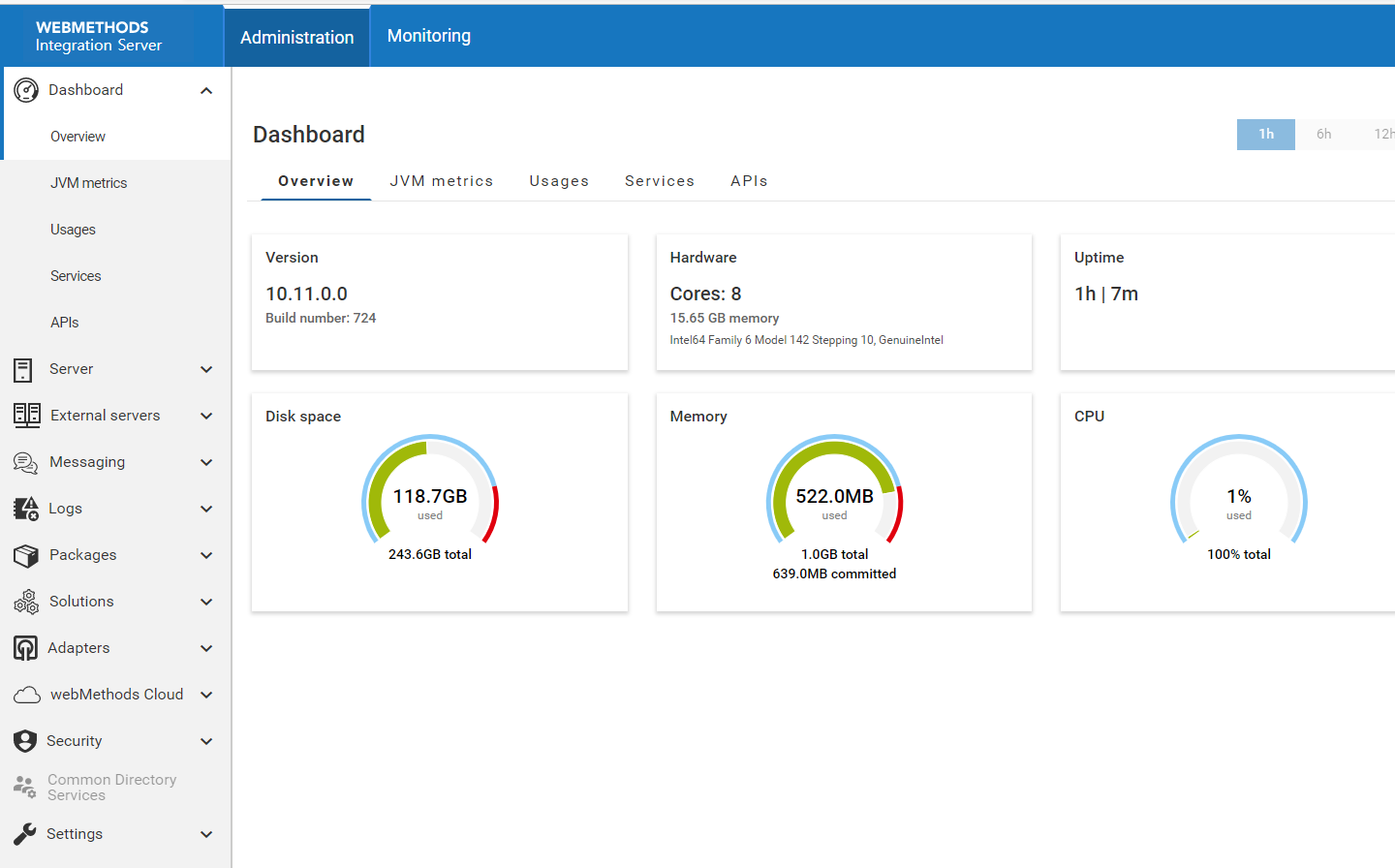

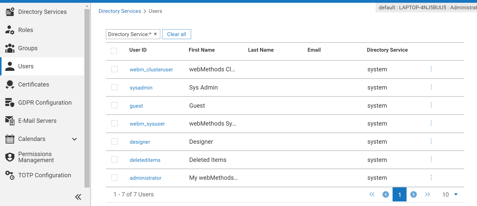

Hi, I’m not able to login to MWS as well. Could you please tell me where the menu in the screenshot is located in the IS Administrator?
By the way, during installation, I entered the administrator password as “!manage2” and tried to log in to the IS Administrator using it, but it did not work. Instead, I was able to log in as “manage”.
Please help. Regards, SJ

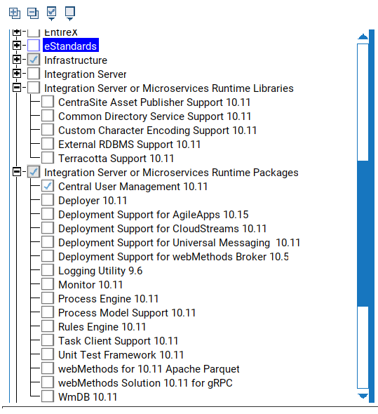

It turned out that the menu was not activated because I didn’t install Central User Management component.
Regards, SJ

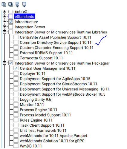

hello i am facing the same problem …but i am not getting directories option maybe because i didn’t install central management component… anyone knows how can i do now?
Hi Abhijeet,
you can download and install the component from the sag installer.
thanks

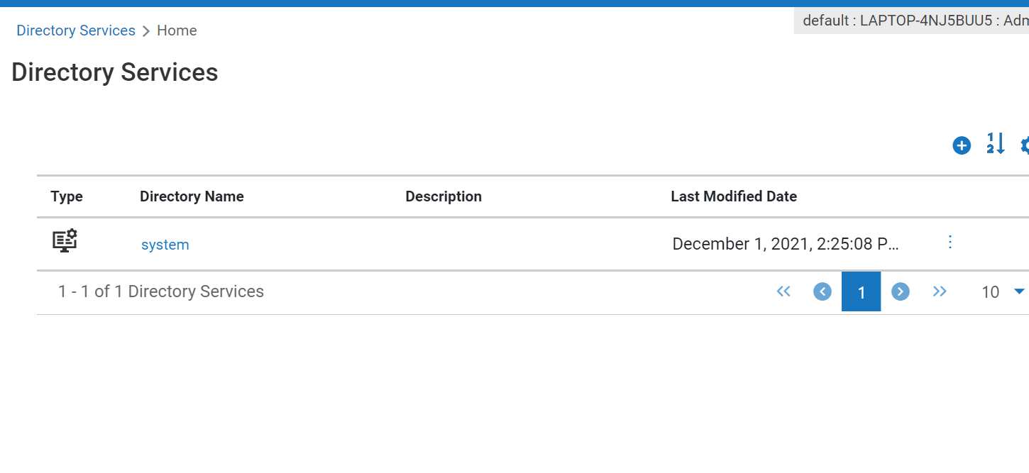

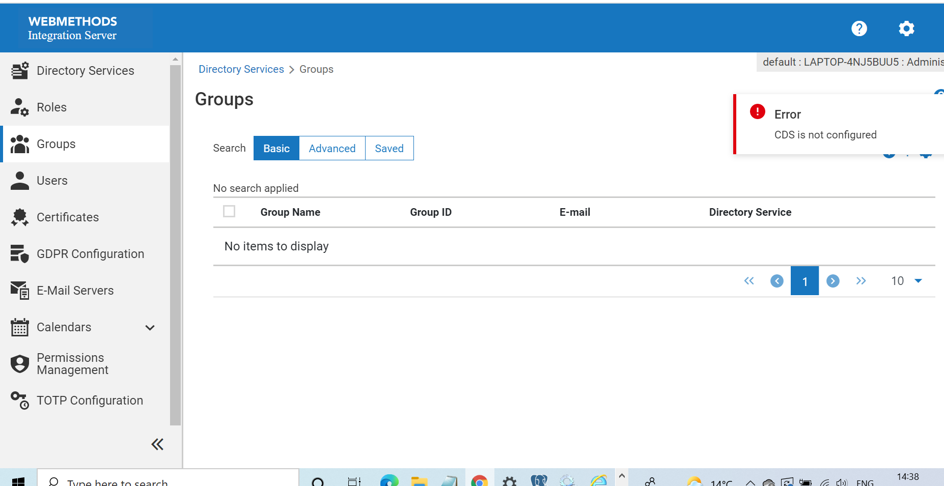

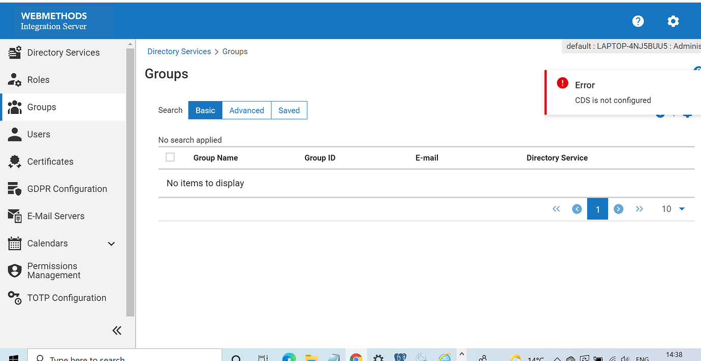

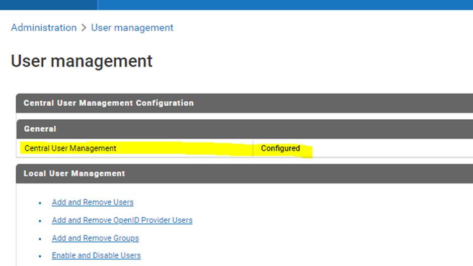

This time i installed the product with central user management. But still in IS page i see central user management is not configured. Both IS and MWS are up and login page is coming but for MWS i am not able to login as it always says wrong credentials. I have tried with every possible pair of credentials.

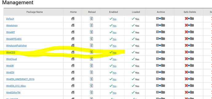

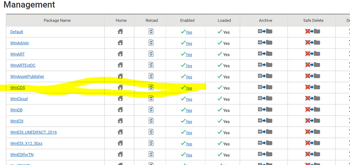

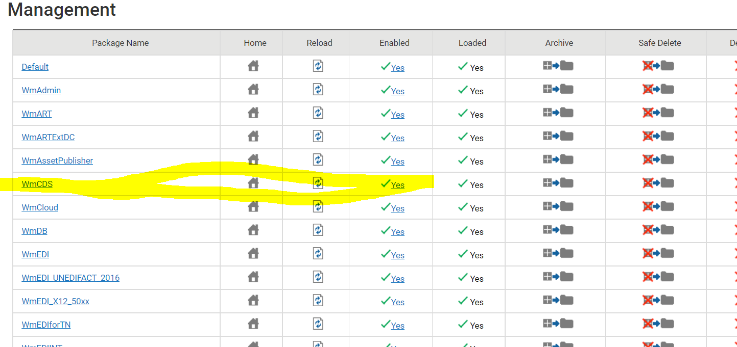

could you check in your IS whether have the WmCDS package and did it turn on?
Thanks
Kind regards, Alex Foo
Yes it is present.

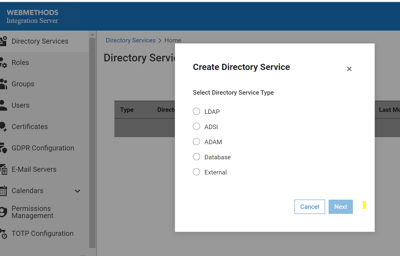

May be i have to create a directory service but dont know how can i create and which one to select

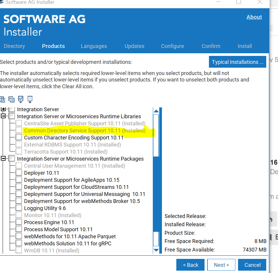

could you check again whether you have download and install the common directory support?
how can i install it in already installed IS? or i have to uninstall and install again?
i checked my installer, i have already installed it.
Hi there, have you also configured the CentralUsers JDBC setting ?
Admin → Settings → JDBC Pools → CentralUsers
John.
Hello John,
Thanks alot it worked. But still i am not able to login in MWS. Can you tell which username and password will work?

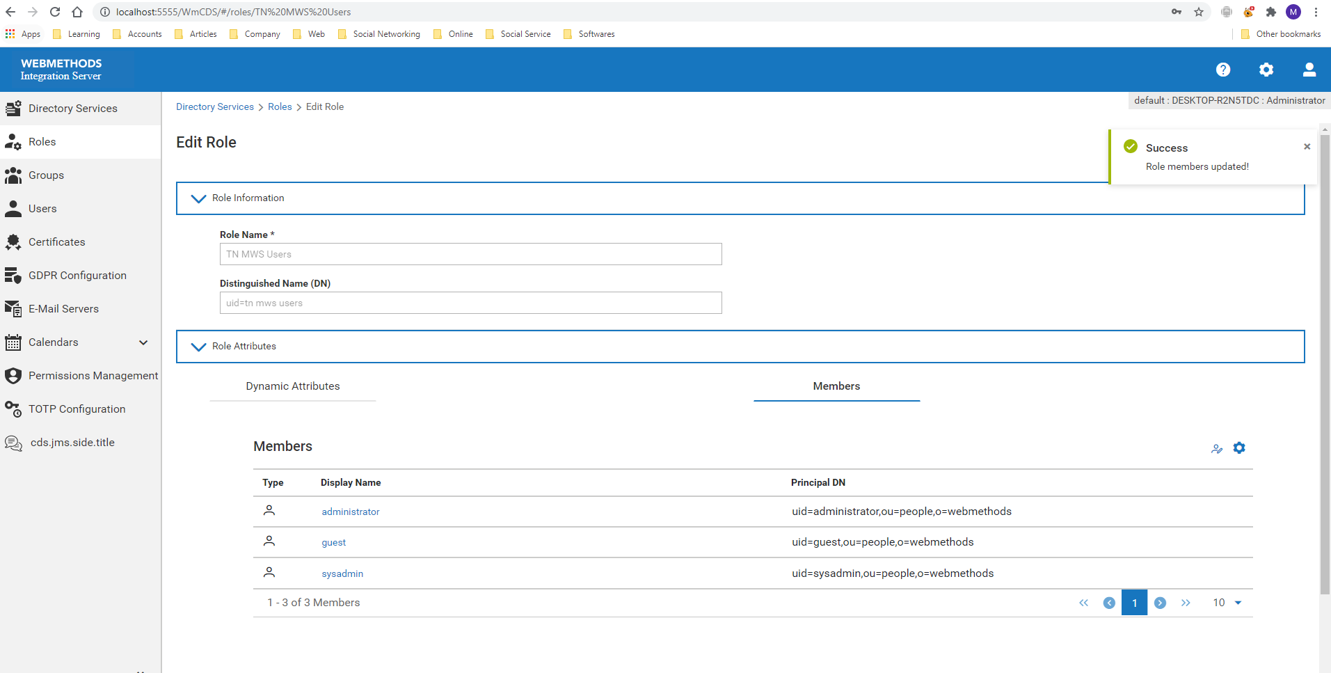

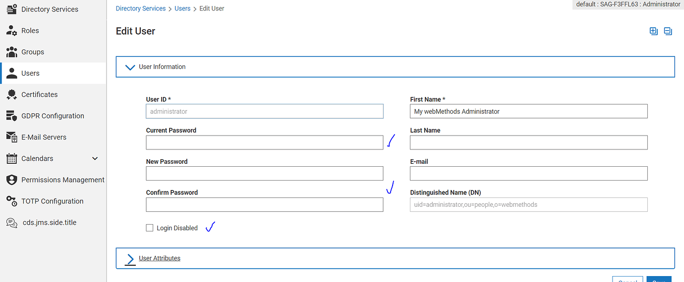

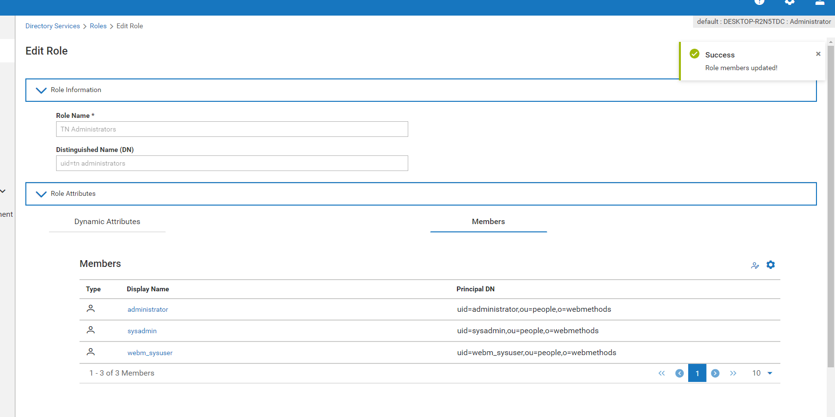

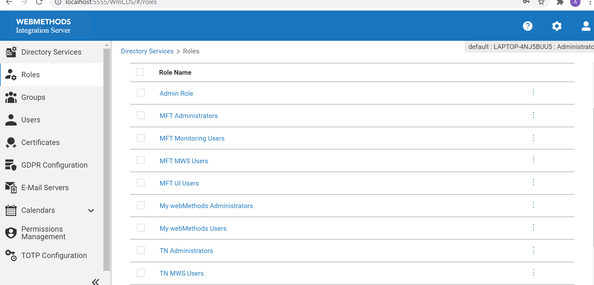

I have edited the roles as alex said but still not able to login in MWS.

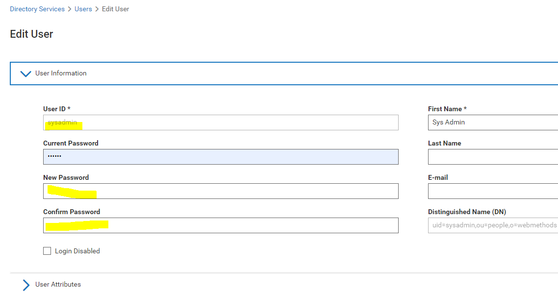

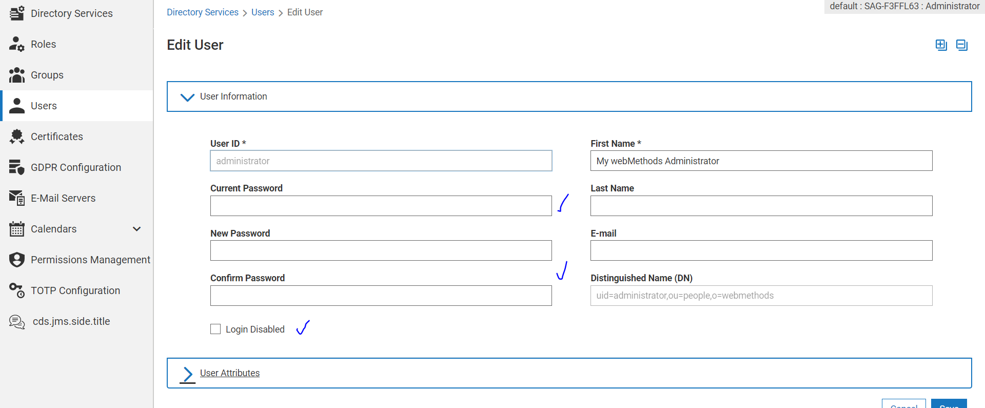

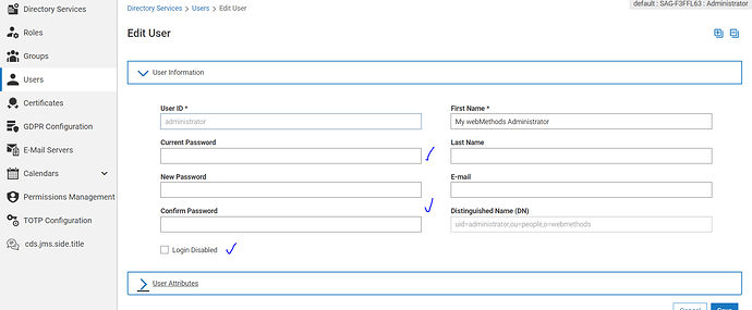

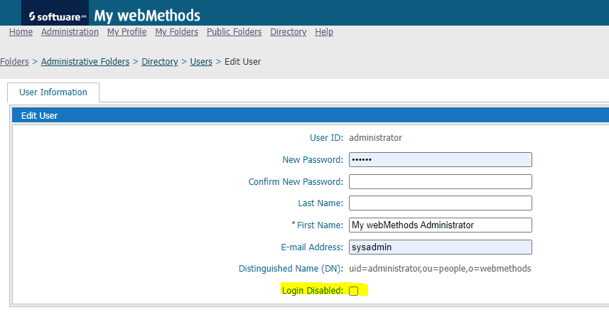

Could you check your admin user have unclick the login disabled?
Beside, stop MWS, in IS, unclick the login disabled, change the admin password again and save. Then restart IS and start MWS. Try again whether you are able to login.

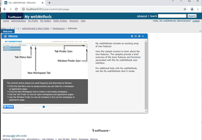

Hello Alex,

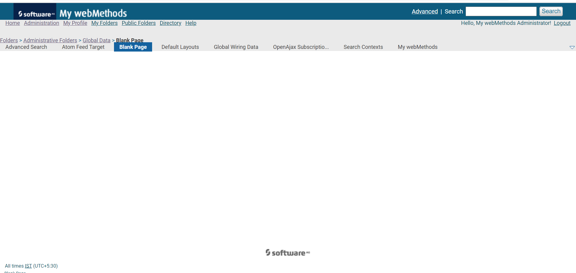

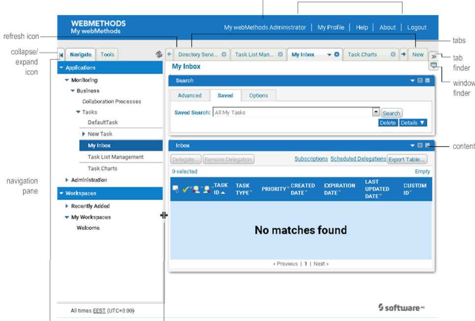

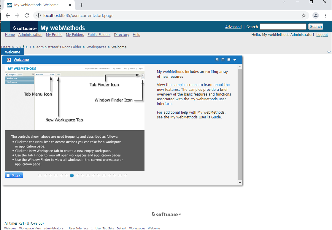

Thanks it worked. But i am getting MWS page like this…Any idea how can i fix this?
Here is the first page.
I looked over 10-11_Administering_My_Webmethods_Server.pdf and 10-11_Working_with_My_webMethods.pdf, but had no luck to solve this problem.
Please help.

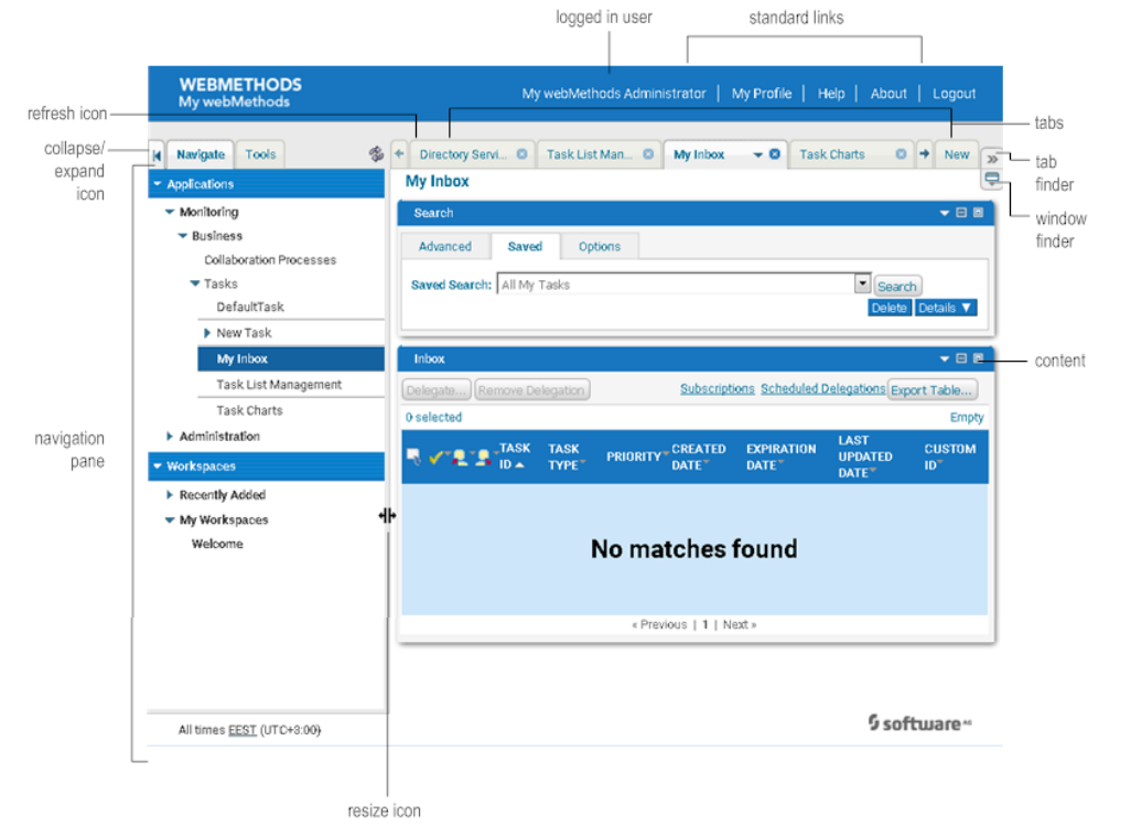

Then, we can login to MWS by using Administrator user. However, there seems to be a part that I did something wrong. So I can’t see the Navigate below.
It Worked :). Thanks a lot SJ.
