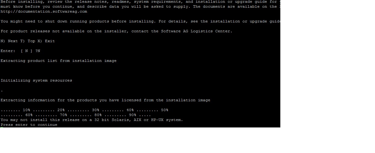

    Hi,
    When we are trying to installing the webMethods 10.1 version in AIX box, it is getting error like,
    You may not install this release on a 32 bit Solaris, AIX or HP-UX system. Press enter to continue
    AIX kernal is 64.
    Could you please help on this?
    Thanks and Regards,
    Srinivas

    Review system requirements guide for supported OS matrix.
    Please check with your OS Administrator and can you run the below command as root on your AIX. Kindly share the results.
    bootinfo -y
    bootinfo -K
