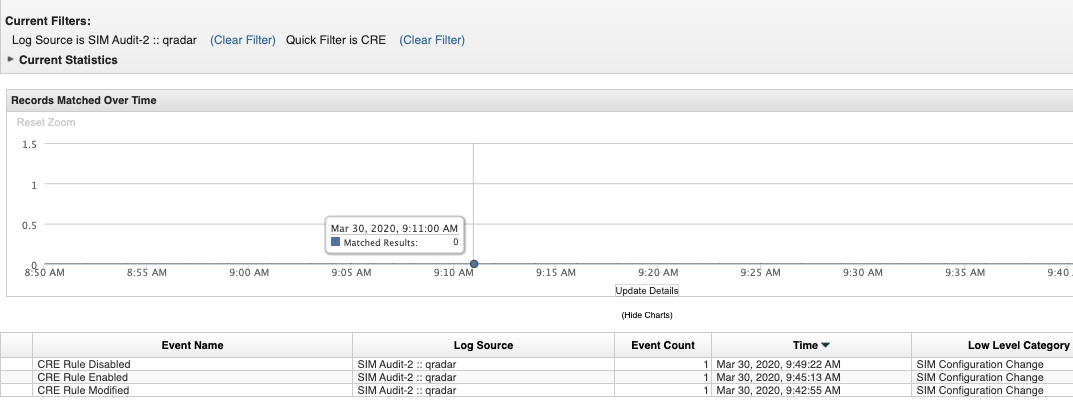

    have you ever tried searching the audit log? I'm sure you can make a report out of it. I have attached an example.

    you can use the Audit Logs of QRadar either with the CLI or with the WebGUI. Just filter on log source 'SIM Audit-2' and low level category 'SIM Configuration Change'.
    I hope this helps...
    Kind regards,
    Volker

    Volker is correct in seeing what has changed using that log source, but the problem I think you also have is policing change and versioning of any changes (I have seen this challenge in my environment).
    QRadar is great in a number of areas however does not have any concept of versioning (e.g. roll back a change) nor policing of change (i.e. permitting change only on parts of the configuration).
    It is a bit of a weakness given other real-time multi-tenant [voice/carrier] systems have had versioning/policing functions since the 1990s. For us this is more problematic when the SIEM is larger with multiple tenants or operating as a MSSP.
    I'll chat behind the scenes to see where this sits in the list of to-dos with the development community.
