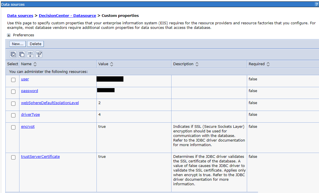

    Thanks Herman. As you suggested, we did manual sync and the problem was fixed. However, we cannot connect to the DataSource. The Exception shown in the logs of the node agent:
    [12/14/23 11:00:22:679 UTC] 0000008c DataSourceCon E   DSRA8040I: Failed to connect to the DataSource "jdbc/ilogDataSource".  Encountered java.sql.SQLException: The driver could not establish a secure connection to SQL Server by using Secure Sockets Layer (SSL) encryption. Error: "SQL Server did not return a response. The connection has been closed. ClientConnectionId:2c98d6a4-bd5e-48e0-9e5f-324f19da5b1b". DSRA0010E: SQL State = 08S01, Error Code = 0
    at com.microsoft.sqlserver.jdbc.SQLServerConnection.terminate(SQLServerConnection.java:1667)
    at com.microsoft.sqlserver.jdbc.TDSChannel.enableSSL(IOBuffer.java:1668)
    at com.microsoft.sqlserver.jdbc.SQLServerConnection.connectHelper(SQLServerConnection.java:1323)
    at com.microsoft.sqlserver.jdbc.SQLServerConnection.login(SQLServerConnection.java:991)
    at com.microsoft.sqlserver.jdbc.SQLServerConnection.connect(SQLServerConnection.java:827)
    at com.microsoft.sqlserver.jdbc.SQLServerDataSource.getConnectionInternal(SQLServerDataSource.java:621)
    The database server certificate is added to the certificate container (trust.p12) of the Cell and the Nodes.
    The environment is:
    • WebSphere Platform 8.5.5.18
    • Java version: 1.8.0_261
    • SQLDriver: sqljdbc4.jar
    The custom properties of the DataSource, as shown in the picture:
    Any suggestions?
    Thanks in advance.
    Best regards.

  • 4.  RE: WAS 8.5.5.18 | Sync problem between dmgr and node agents
    Posted Thu December 14, 2023 10:35 AM
    Hello,
    is this the only error message you get when you try to connect? No further messages in the logs? The error says "SQL Server did not return a response" so are you sure the request hits teh SQL Server? Or is there probably a Firewall in between preventing the connection? What is the status of the sockets? If you start a tcpdump while trying to connect - which packets are flowing? You are trying to connect via SSL - does the DB server connect SSL? Any messages at the DB server side?
    Hope that helps to investigate further but unforunately that's all I can say from the message.
    Have a good day, Hermann
    P.S: I guess you are aware but your WebSphere Application Server code WAS 8.5.5.18 is quite outdated and old (over three! years). Not saying that it is related to the connection issue but definitely a (security) risk!

    Posted Mon December 18, 2023 06:43 AM
    Hello Hermann,
    We have updated the JDBC Driver to 4.2 version, ant it worked.
    Thanks all!
