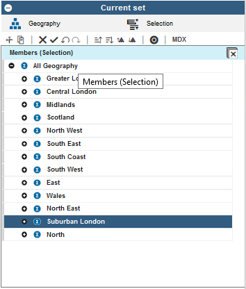

    Those two sites do not appear in the created Geography hierarchy (or any of the other virtual hierarchies) even though they are in the Sites dimension with valid attributes that do appear in the hierarchy.
    So, for example, All Geographies includes South East and South East includes 9015270, but it doesn't include 9114040 when it should contain both as they both have the same Geography attribute in the Sites dimension.
    This is the total and parent levels which are correctly represented.
    Most sites appear in their correct geographical subtotal, but there are a few sites, like the two mentioned, that do not.
    Hierarchy top level
