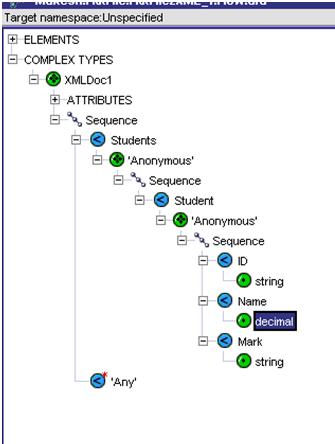

    I have to validate my document “student” by usering IS schema & the pub.schema.validate.
    I have document student mention is below and in attchement pic.
    student (Doc)
    —Student (Doc list)
    -----ID
    -----Name
    -----Mark

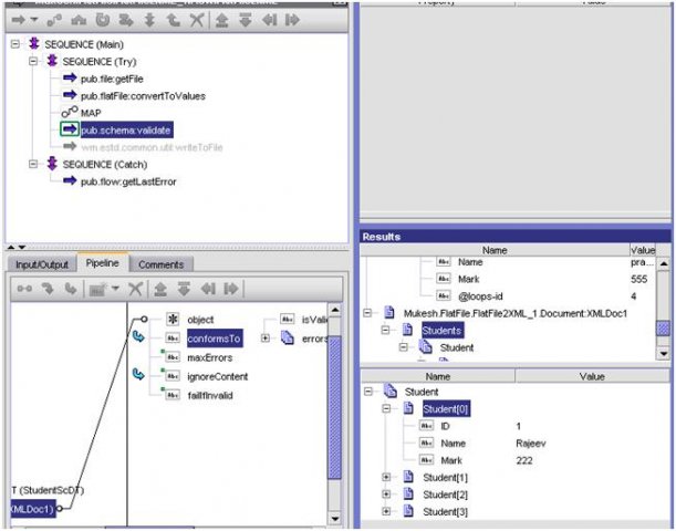

    In pub.Schema:validation
    In Object I have map my student doc. And in conforms to i have map schema that i have create by using the XSD file.
    XSD file and IS schema is attached …
    I m getting Error:
    [ISS.0062.9024] Integration Server does not support this type of object in validation >>>BasicData:Students=>>>BasicData:Student=[0]>>>BasicData:ID=1,Name=Rajeev,Mark=222<<<,[1]>>>BasicData:ID=2,Name=Chetan,Mark=333<<<,[2]>>>BasicData:ID=3,Name=Pooja,Mark=444<<<,[3]>>>BasicData:ID=4,Name=pradeep,Mark=555<<<<<<<<<
    Please let me …i have went through the previous doc but its not clear to me …
    please any help will be appreciable…[ATTACH=CONFIG]854[/ATTACH][ATTACH=CONFIG]855[/ATTACH]

    for the validation service, make sure to use the right parameter:
    object :
    Document or com.wm.lang.xml.Document or com.wm.lang.xml.Node
    Object to be validated.
    conformsTo:
    String Document type or schema to validate object against.
    ? If object is a document (Data object), conformsTo must specify
    the fully qualified name of a document type on the
    Integration Server.
    ? If object is a com.wm.lang.xml.Document or com.wm.lang.xml.Node
    object, conformsTo must specify the fully qualified name of an
    IS schema on the Integration Server.
    Check the Built-In Services Reference for details.

  • 4.  RE: validation by IS Schema
    Posted 06/11/12 08:06 AM
    Use services pub.xml:xmlStringToXMLNode, pub.xml:xmlNodeToDocument
