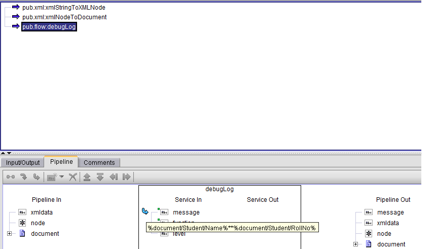

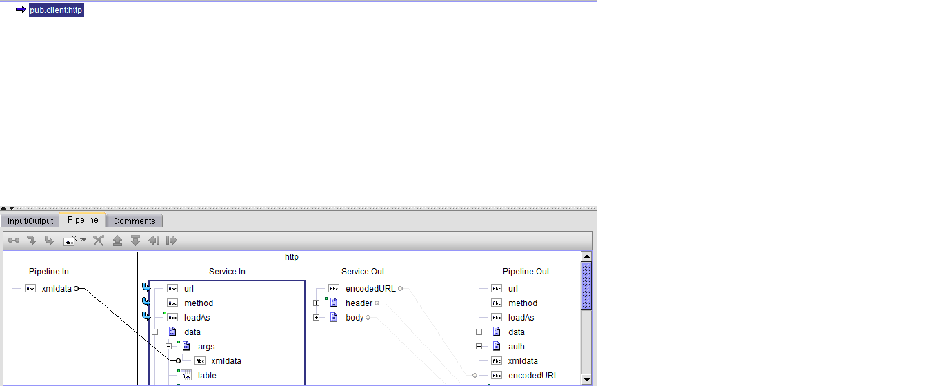

    Input xmldata
    <?xml version="1.0"?> Test1 Test123
    1.HTTPProcess.png contains the pub.client:http which has input a string variable xmldata and it is mapped to data/args/xmldata.
    1. receiveHTTP.png contains pub.xml:xmlStringToNode , xmlNodeToDocument and debug log step. The input for this step is xmldata string variable which is same as the input used in 1st step.
    3.Output.png contains the output which is %document/Student/Name%%document/Student/RollNo% at run time this are replaced as [b]Test1Test123.[/b]
    For your comment
    What variable you mapped $xmldata or xmldata or just any string? and I assume your receiving service input is *node object along with content-type=text/xml is must.
    I have not given the value for headers as content-type=text/xml but still I am getting the output.
    Correct me if I am wrong with the above approach.
