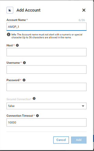

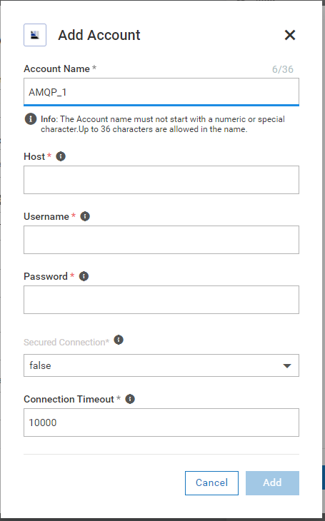

    We are trying to configure wmio amqp trigger with azure service bus.
    azure service bus supports amqp protocol : Overview of AMQP 1.0 in Azure Service Bus - Azure Service Bus | Microsoft Learn
    I’ve tried numerous combinaison to configure the connection.

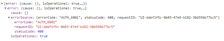

    Each time getting this message
    In network console,
    what sounds to be authentication issue.
    Combinaison tried
    Host :
    • amqp://my_instance.servicebus.windows.net
    • amqp://my_instance.servicebus.windows.net:5671
    • amqp://my_instance.servicebus.windows.net:5672
    • amqp://my_instance.servicebus.windows.net:443
    • amqps://my_instance.servicebus.windows.net
    • my_instance.servicebus.windows.net:5671
    • my_instance.servicebus.windows.net:5672
    • my_instance.servicebus.windows.net:443
    Username :
    • Shared Access policy created
    Password :
    • Primary key associated to Shared Access policy
    • Primary key associated to Shared Access policy (url encoded)
    Secure connection : true/false
    If anyone has a clue, that would be cool :slight_smile:

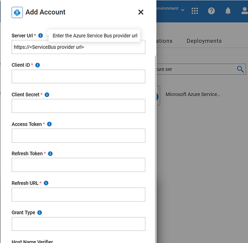

    Hello Engin, thanks for your help.
    Are you refering to the “AMQP workflow trigger” or the “azure service bus” block credentials ?
    Because I understand help of postman (or similar) for getting the oauth2 authentication for the “azure service bus” block but not for the ampq trigger one ?
    Am i missing something ?
    here a SO article on the format I tried to use without success : jms - Azure Service Bus AMQP Exception - Stack Overflow
    1. username
    2. password (which has to be urlencoded)
    I can connect to the service with service bus explorer, bus using azure protocol and not amqp. I will double check with another tool.

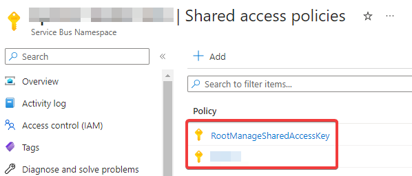

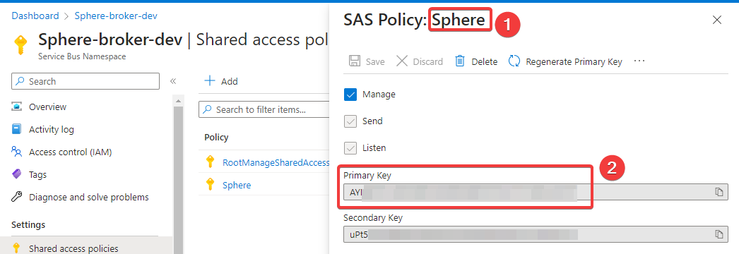

    I wasn’t the one who generated the token unfortunately. But I used the token generated in Azure. If my memory is correct, when generating the token you need to set permissions for that token. If the permissions are set correctly you should be able to call it using a simpler interface. I was following this method because it is really difficult to detect the actual problem when there is one and its even more difficult if there is more.
    I would check Access Control settings for token first and then test it using something simpler.

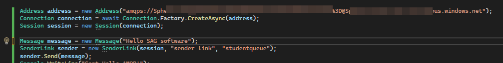

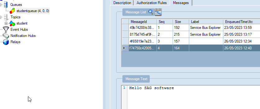

    Hello Engin,
    I quickly dropped a message in amqp protocol to azure service bus successfully.
    back to WMIO, with those credentials, I still can’t make it work.

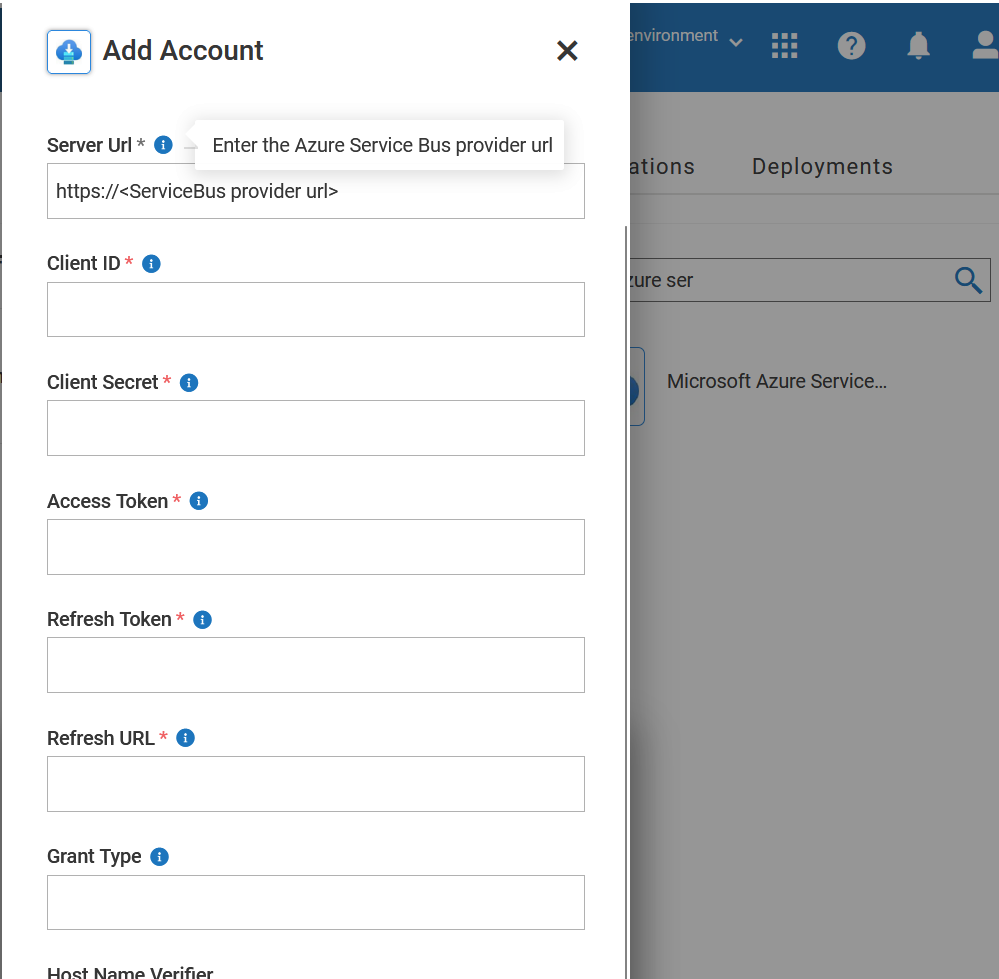

    Hey, no :slight_smile: we are trying on purpose to use the “AMPQ workflow trigger” rather the “azure service bus” connector one. (as mentioned in my initial message, including capture of the AMQP connecteur settings panel)
    Why:
    • Azure Service Bus is compatible with AMQP protocol (which is a standard. source)
    • We want to trigger workflow when messages on specific queue or subscriber are received. (can’t make this with the standard azure service bus connector except if linked with a clock trigger: buy buy event driven)
    • we have already a tenant and a contract with microsoft azure, including protection of our data (GDPR and stuff).
    Fabien

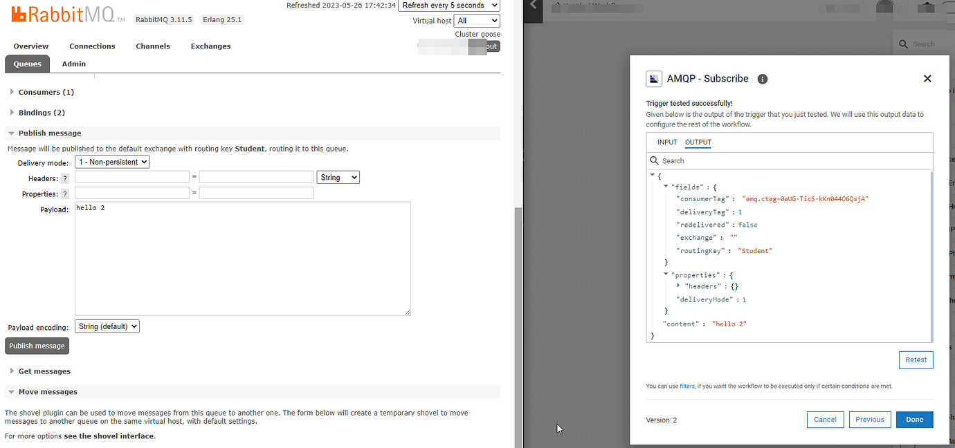

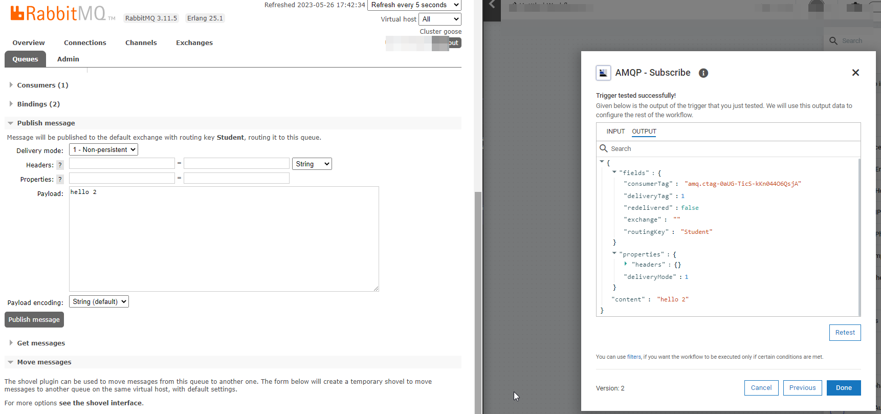

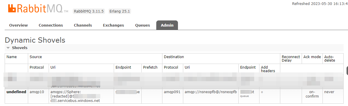

    Far from ideal, but made it works with an intermediate rabbitmq instance.
    1. azure service bus
    2. rabbitmq with shovel plugin configure (bridge between amqp 1.0 and amqp 0.9.1)
    3. wmio with amqp trigger
