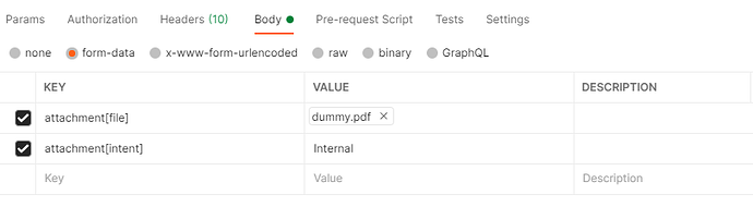

    I have gone through a lot of posts on how to upload a file using post method of pub.client.http but still not able to get success. Below is my requirement from postman. I am uploading a dummy file by passing these two key value in Body in postman
    I have uploaded the steps I tried to upload the file. I am getting http 200 but error from API response. I am using webMethods 9.10. I cannot use java service as per client’s requirement. Appreciate your help in this.

    Without looking in any real detail - are you setting the right content-type (multipart/form-data) in the headers on the http service?
    Postman tends to do this automatically for you, so sometimes I’ve seen people forget about this when they try to replicate a call into integration server.

    From the screen shot, it seems you are trying to send multipart data. To replicate this in IS, you need to build MIME data and then set it as a stream or byte to pub.client:http data variable.
