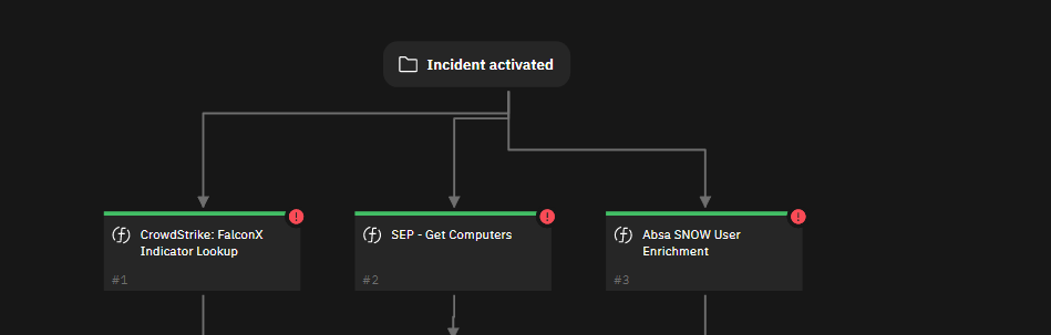

    Hi All,
    We are working on building a playbook where we will be enriching artifacts like Hostname, Username, IP Address using 3rd party tools.
    If playbook is an incident activated playbook than how can we take different artifacts inside our playbook task.
    For example : 1st task inside playbook will be used for enriching Hostname. Than how do we pass only hostname inside 1st task.
