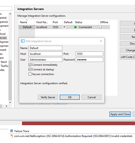

  • 4.  RE: Unit Test Framework - Authorization Required: [ISS.0084.9001] Invalid credentials
    Posted Fri March 13, 2020 04:47 AM
    thanks for response,
    Yes, I checked the credentials in the Preferences and also the default connection. Everything is OK and the Designer can connect (as Administrator) to the IS (proof in the Attachment). In the Service Development perspective I can also edit/run the service I use in the unit test.
    I tried uninstalling/installing the Unit Test framework through the 10.3 installer. No luck.

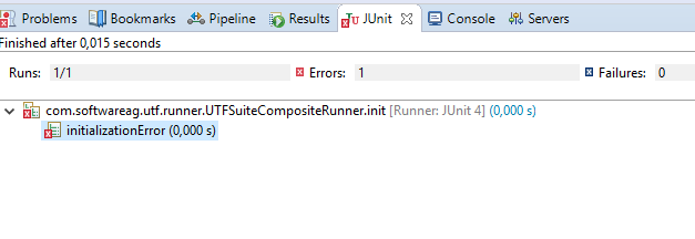

  • 6.  RE: Unit Test Framework - Authorization Required: [ISS.0084.9001] Invalid credentials
    Posted Thu March 19, 2020 05:18 AM
    Im using the latest fixes for Unit Test Framework - release 10.3.0.0001-0010
    There is no user named "? $ . 4 4 " never was , im running the tests under Administrator (confirmed) after a clean install. So this way i don’t know why the IS server log is reporting > Authentication of user "? $ . 4 4 " failed.
    The JUnit stack trace is an initialization error. Screenshot in attachment…
    The Designer console is empty.
    The failure trace only shows one line:
