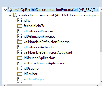

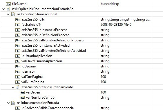

    I have a SOAP service publised in API GATEWAY. It works well. Ive enabled REST transformation feature in API Gateway in order to get JSON REST requests. But when I receive the información on IS, the request look like this:
    As you see, some variables have the “axis2ns355” prefix. Actually those variable are the “Optional” and “Null” variables on the request document:
    I cant change all the request variables to required. How can I solve this by API Gateway side?
    I receive the pipeline well when I send it by SOAP request. If I try to send it across the REST API enabled by REST transporfation the request comes with that prefix. Thats the problem.

    This is one of the challenges with generically translating SOAP/XML and JSON. The XML namespaces and associate prefixes are not something that can be generically dealt with. A default namespace adds even more interest to the mix.
    Is there a specific need to have the API GW pass JSON to IS in this case? Why not just receive the original XML (is this actually SOAP or is it plain XML – cannot tell for sure from the screen shot)?
    One of the things that might cause an issue is when translating from XML to JSON, there is no way to know for sure if an XML element is supposed to be in an array or not. A single-item list in XML is indistinguishable from a stand-alone element. In this case, the translation will be wrong because the generic translation will not know to place the single item into a list.
    If you really need to translate XML to JSON, I would suggest doing so within IS with the help of doc types and XSD. The generic translation in API GW has limitations due to ambiguities of XML.

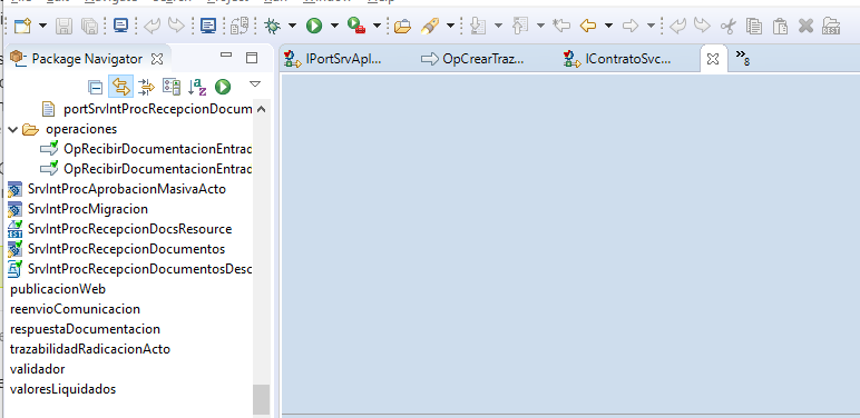

    In the other hand, why am not I using the REST RESOURCE and REST API DESCRIPTOR feature on IS and then publish them on API Gateway? That’s because and error when Im creating the RES API DESCRIPTOR, I dont know the reason but when I create a REST API DESCRIPTOR then it get corrupt
    The REST API Descriptor doesnt even open correctly and a error message “Descriptor nameofdescriptor not exists”. Thats the reason why Im not using and API Descriptior
