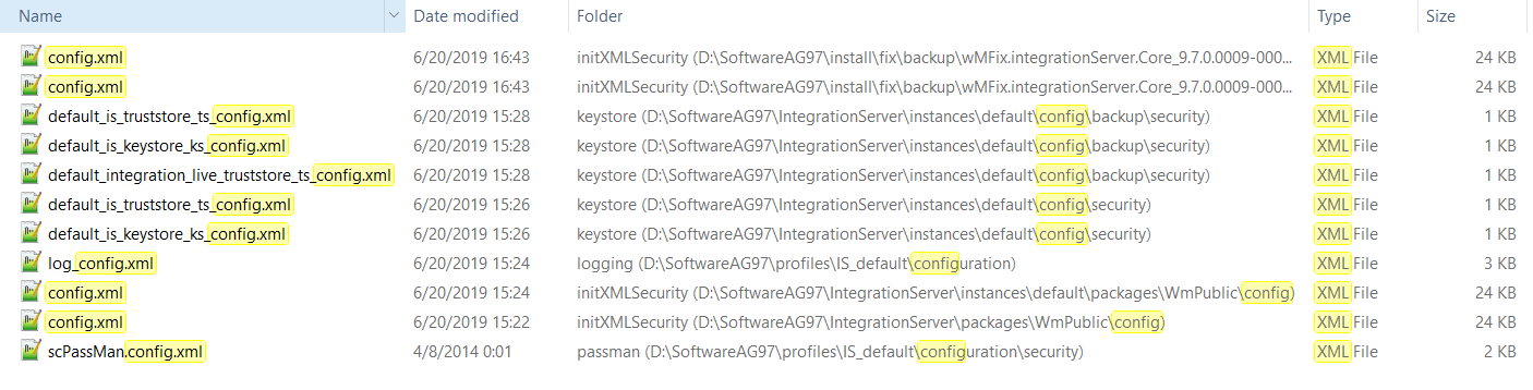

  • 6.  RE: Unable to start the Integration Server in webMethods 9.7
    Posted Fri June 21, 2019 06:06 AM
    Hello Yogesh,
    I couldn’t find “tc-config.xml” file.
    Is the issue related to database connection?
    Thank you.
