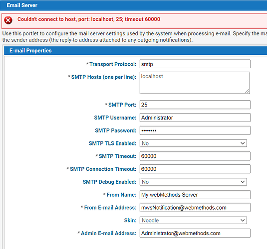

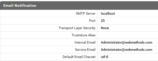

    Hi Mike & Bhaskar,
    I’m trying to send an email from internal (localhost) to a gmail account. I also have configured SMTP server on the IS admin page however I am not sure if I did it correctly. Please see below snippets for the details.
    MFT:
    IS Admin:
    Settings->Resources
    Settings->Extended

  • 5.  RE: Unable to Send Email in MFT (Post-Processing Rule)
    Posted Thu October 22, 2020 05:01 AM
    Hi,
    You have configured you SMTP server host as localhost, are you sure if SMTP server is hosted locally?
    Thanks,
    Bhaskar
    #Managed-File-Transfer
    #webMethods
    #B2B-Integration
  • 6.  RE: Unable to Send Email in MFT (Post-Processing Rule)
    Posted Fri October 23, 2020 10:50 PM
    Your configuration here has a prerequisite, an email server must be online running on the same machine. Have you ensure that you’ve such server in place? If you don’t have, I suggest you to download https://www.hmailserver.com/ and setup the email account there. Then your MFT configuration can connect to the hmailserver via TCP port 25.

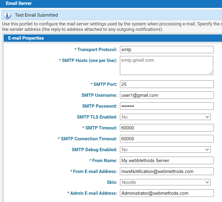

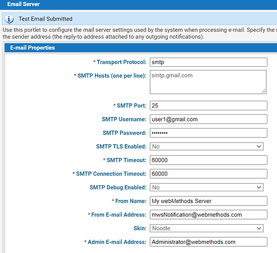

    Thank you for your help, I am now able to send an email from MFT to a gmail account. I downloaded the hmailserver and created a domain “gmail.com” and then created a user and opened the new account using thunderbird.
    MFT configuration:
    Send email action (ActiveTransfer):
    Email received:
