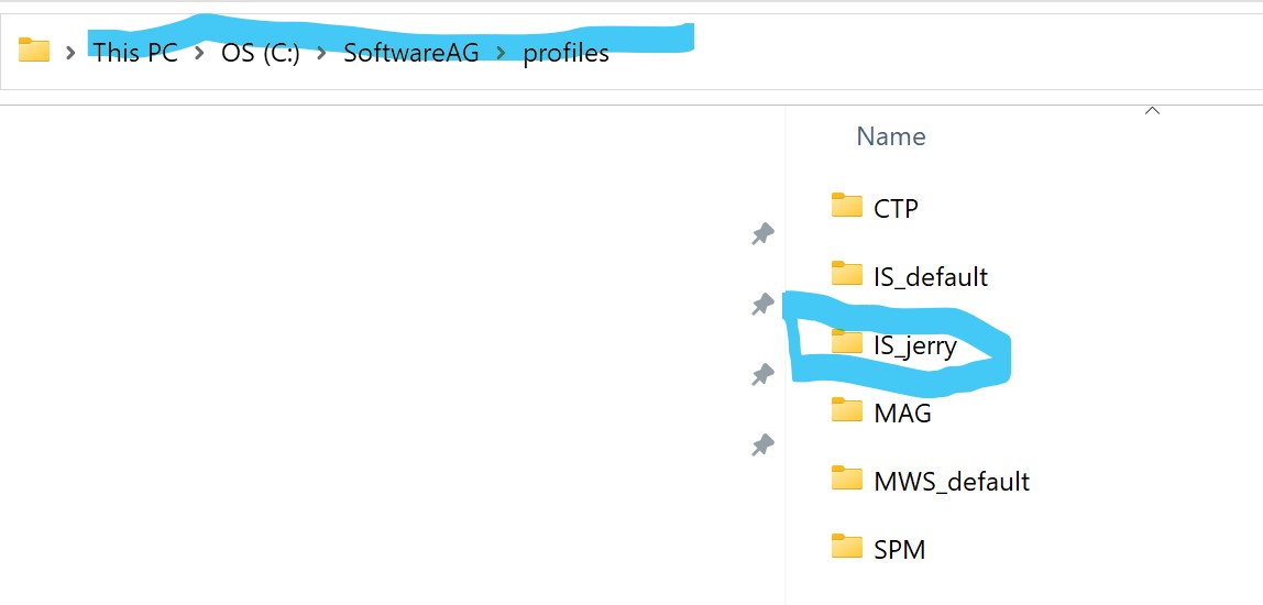

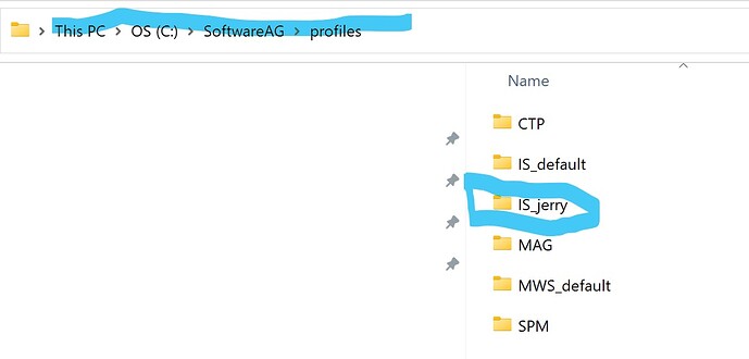

  • 3.  RE: Unable to launch new Integration Server Instance
    Posted Mon June 20, 2022 03:12 PM
    Hi Wayne,
    I see the new instance created in the file system the attached is the output of the ANT script for the instance creation attached file “Instance_creation_output_2.txt”.
    Instance_creation_output_2.txt (106.0 KB)
    The folders are created under the profiles directory, attached screenshot “ScreenshotFromDirectorySystem.jpg”, the instance also appears under the start menu for Software AG.
    However on trying to launch it it just terminates, atttached are the 3 runtime logs
