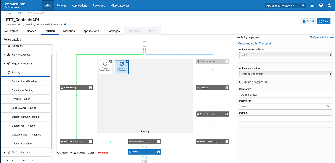

    HTTP 401 means you’re not presenting credentials when calling the API exposed by the IS.
    A convenient way of configuring the gateway to present these credentials is to configure an “Outbound Auth - Transport” policy. See the attached screenshot.
    All this can be “externalized” using an alias of type “HTTP Transport security alias”.

    Thank you so much Stephane.
    Solution Provided by you worked.
    Here we can add any authentication scheme present that is supported by native resource server and APIGW.
