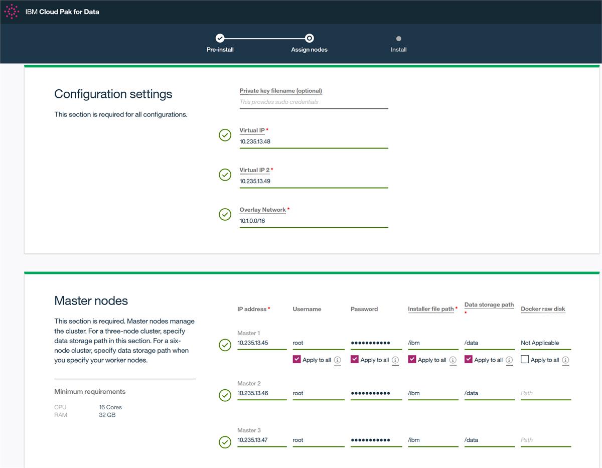

    I am able to start the installation from the web interface
    Filled out the form accordingly
    The bottom of the page shows "pre-install checks running" - it has been showing that message for about one and a half hour
    the log shows:
    2019-09-29 19:06:47 UTC - Validating configure file
    2019-09-29 19:06:47 UTC - Configure file is validated
    2019-09-29 19:06:47 UTC - Initializing Setup: Setting up ansible groups and corresponding variables
    2019-09-29 19:06:47 UTC - The password is empty, the installer will exit

    The file is not in the in the tmp folder, also there was no reference of it in the installation guide. The wdp.conf file got created by the wizard. I was able to overcome the issue by running the install with the wdp.conf file but now it is stuck for a while on the step below - any suggestions ? the hosts are in a data center with plenty of bandwidth
    thanks
    Installing on a 3 node cluster, each with 16 cores and 64 GB RAM
    lates version of icp4d

    Initially  I was installing Cloud Pak by using the web browser UI - that did not go well - then I switched the approach by using the:  "Installing Cloud Pak for Data with a configuration file" (wdp.conf) I added an id_rsa line to the wdp.conf file and copied the file to the install directory
