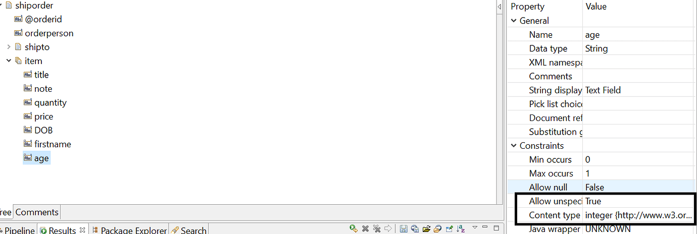

    Yes i can see the operators coming in for the fields defined as date.But when i import a xml schema having integer fields,it still appears as string fields in the document and data model.
    For eg if below are defined in xsd:
    <xs:element name=“DOB” type=“xs:date” minOccurs=“0” maxOccurs=“1” />
    <xs:element name=“firstname” type=“xs:string” minOccurs=“0” maxOccurs=“1” />
    <xs:element name=“age” type=“xs:integer” minOccurs=“0” maxOccurs=“1” />
    when imported the first 2 fields datatype appear as date and string respectively,but the third field still appears as string even though declared as Integer.
    Also if i try to manually create doc in designer there is no option for setting Datatype as integer,could see options as string,xml reference,document,etc.
    Can you kindly comment on this.

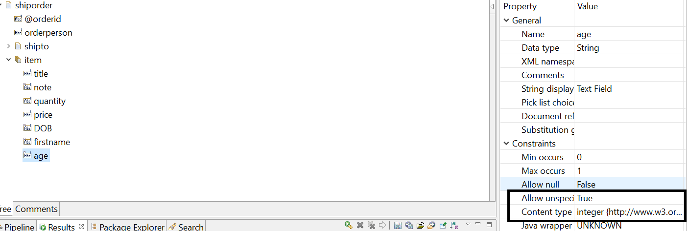

    When you export xsd , for the integer field the data type appears as string but the corresponding content type is set to integer.
    which is used to do validation of the data.
    see the screenshot attached.

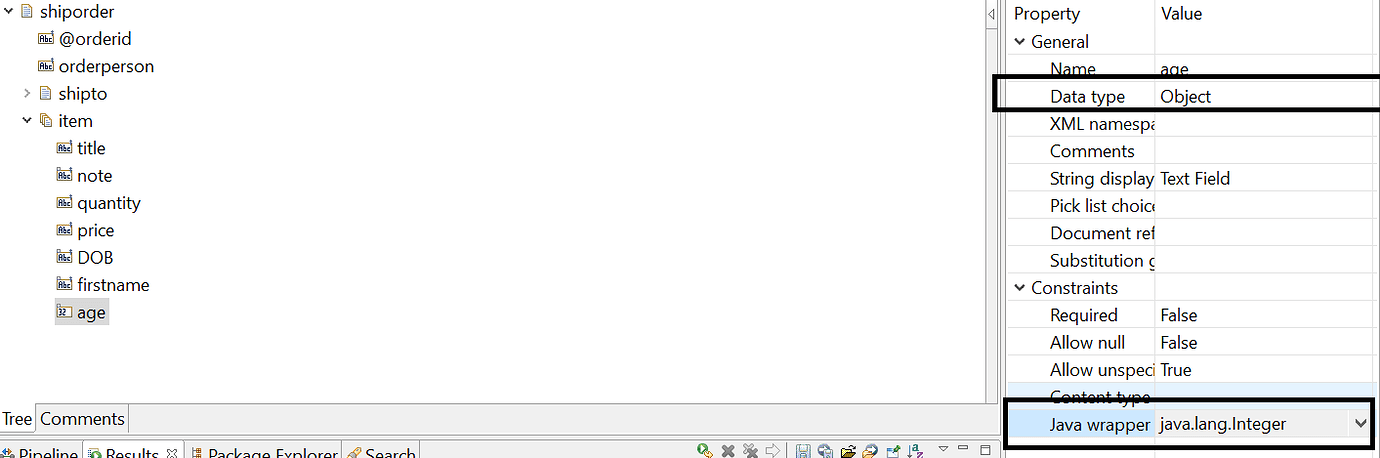

    In order to create an integer field manually , you need to first select the data type as object , then from the Java wrapper select the corresponding java wrapper for integer i.e java.lang.Integer

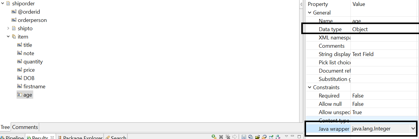

    Sorry for bothering on this.But if i manually create a field having datatype as Object and contenttype as java.lang.integer im not able to select that field when creating the decision table in rule project :frowning:
    And also for the xsd as per your comments when importing integer field from xsd , datatype appears as String and contenttype as java.lang.integer ,then should we manually change the integer fields after importing from xsd everytime before using the document as datamodel?Because we have many business rules mainly on the integer fields which requires >,< operators for the rule.

    Not conent type , the corresponding Java wrapper type should be selected as java.lang.Integer.
    Also when you change the document which is used as a data model , then you need to sync the data model from the Business Rules perspective.

  • 11.  RE: Unable to export Business Rule in wM9.12
    Posted Thu January 12, 2017 03:42 AM
    Hi Rakesh,
    Sorry,i overlooked your response.
    Its working now if i set the wrapper type.
    Thank you very much :)I am able to successfully work and export projects to IS.

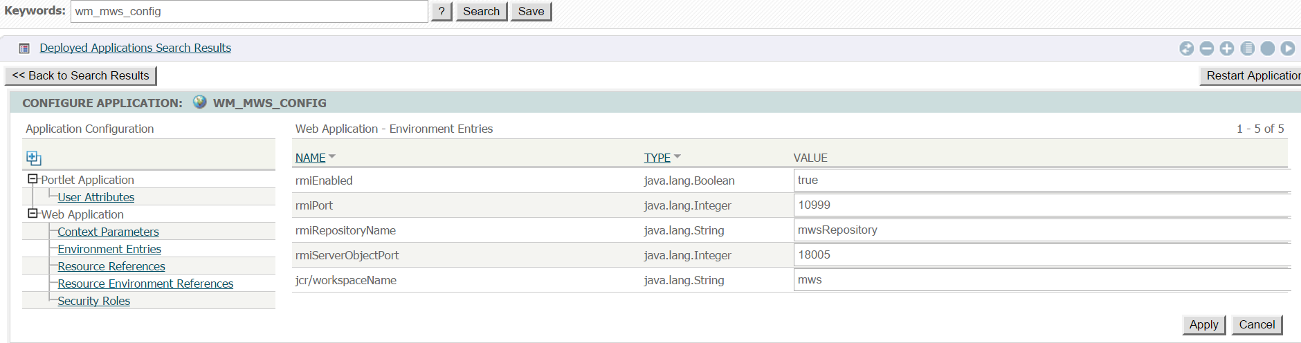

  • 17.  RE: Unable to export Business Rule in wM9.12
    Posted Tue January 17, 2017 12:20 PM
    Log in as sysadmin to MWS. Go to: “Administrative Folders > Administration
    Dashboard > Configuration > CAF Application Runtime Configuration”.
    Search the deployed applications for “wm_mws_config”.
    Open the found application.
    Click the “Web Application > Environment Entries” link.
    There you will get all the port entries related to RMI. For exporting rules project we need to connect to rmiPort , default 10999.
    Screenshot attached for reference.
