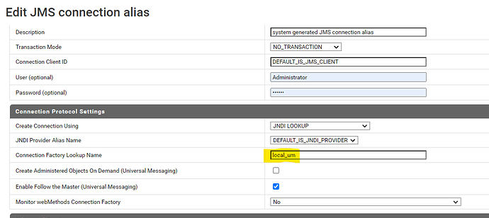

UM is up still the JNDI test Loookup is getting failed
  • 1.  UM is up still the JNDI test Loookup is getting failed
    Posted Fri July 07, 2023 07:01 AM
    webMethods 10.15 version is used.
    ####We are upgrading to webMethods 10.15. The UM is also installed. However, we are not able to connect to 10.15 UM. The 10.15 UM instance is running. I can see the process in the Linux. However JNDI test lookup is not getting connected. Even we are not ale to connect to 10.5 UM also from the 10.15 IS. But the 10.5 UM is connected to 10.5 IS. Need to know if any configuration is missing.
    Logs are given in the below :

    Production (customer)
    ####Production (customer) instance.
    #webMethods
    #Universal-Messaging-Broker
  • 2.  RE: UM is up still the JNDI test Loookup is getting failed
    Posted Fri July 07, 2023 07:13 AM
    @Arup_Sarkar1 Can you check why your IS is not able to reach you UM servers on the respective ports. There is communication connection drop while connecting from IS to UM.

    Did you add the connection factory for JNDI? After creating JNDI context you need to add the connection factory as well. You need to set it to the same name as your IS JNDI settings.
    It should look like this in Enterprise Manager
    and this is what it looks like in IS JMS connection alias

    Recreated the connection factory and it worked.
