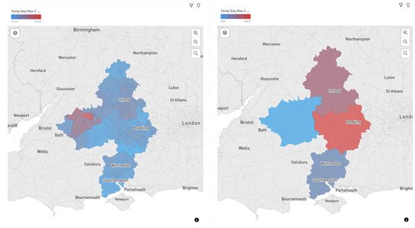

    A lot depends on what you are trying to do. The supplied Mapbox links have built in hierarchies. For example post codes in the UK are supported down to 5 digits. So a post codes of say OX11 8AB, OX11 8AC, OX11 8AD etc are grouped at OX11 8. However you can request just OX11, or even OX which would look something like this;
    The other option is to create your custom ploygon where you group postcodes into say sales area, or more likely use a publicly available one such as those used on Government sites to show electoral areas or population grouping.  You do need to create your own Mapbox logon to upload the Geo Json files. There are some instructions to get you started in the CA manuals at

    By default CA groups Postcodes by area eg OX11 7AB, OX11 7AC, OX11 7 AD would all role up to OX11 7 which is the lowest level supplied in the UK. However if you request at the OX11 data it will role up, and even at the OX area with no need for custom Geo files.
