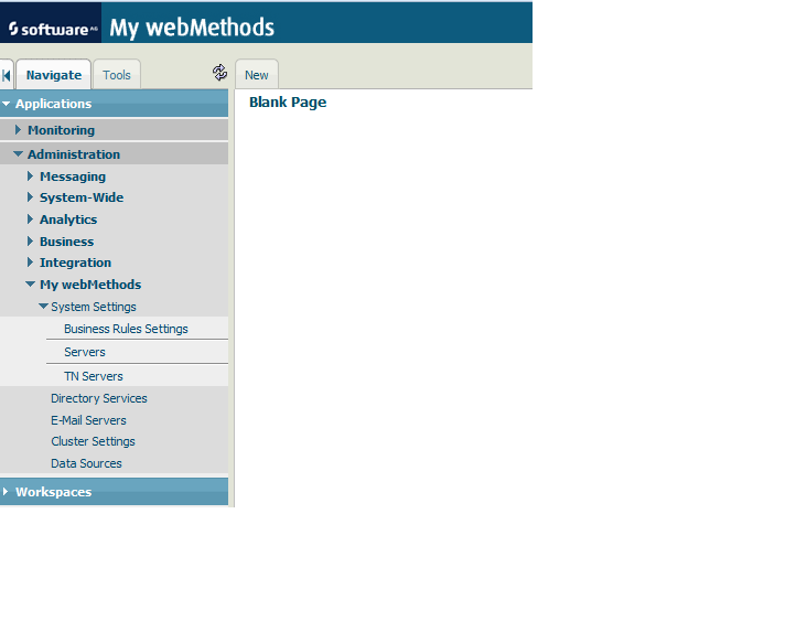

  • 1.  Uable to see Task Engine option in MWS
    Posted Mon April 28, 2014 07:23 AM

    Have installed MWS user interface for task engine? Hope it should solve your issue

    Check under Servers.
    Probably it is displayed there.
    If not, try restarting the MWS (occassionally 2 times).
    It can happen, that MWS takes several restarts until all new components are completely registered.
    If none of the above helps, considere reinstalling the TaskEngine-Part for the MWS.
    As TaskEngine is hosted by the MWS (instead of on the IS like ProcessEngine), there is no separate UI-Entry for this in the installer.
    But you will additionally require the TaskClient-Package for the IS to interoperate with the TaskEngine on the MWS.
    Regards,
    Holger
