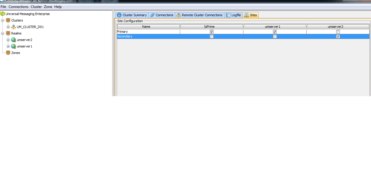

    7. Clicked On cluster name created and then clicked on sites option . Added Primary & secondary sites and then voted Primary for IsPrime .

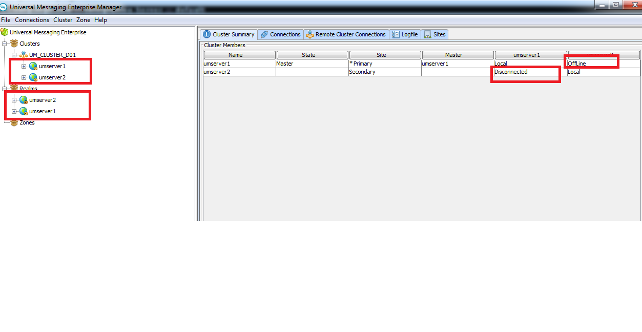

    Now, the problem is in cluster Summary page . The realm servers are showing itself as local but the other as either offline/Disconnected . The screen shots are attached here .
    I tried telnet  one Um host to  another on the docker  public port  and it was getting connected .
    When the messages shown in Cluster summary page is also varying as one realm says other as disconnected and other says as offline ?

    @ MR , I have checked the log files on both realm nodes .
    The logs entry on of the node which is set as secondary keep on populating with message as
    Cluster> Setting potential master to umserver2 yet master count is only 1.0 while we we need more than 1.0 for quorum
    while the another node as message as

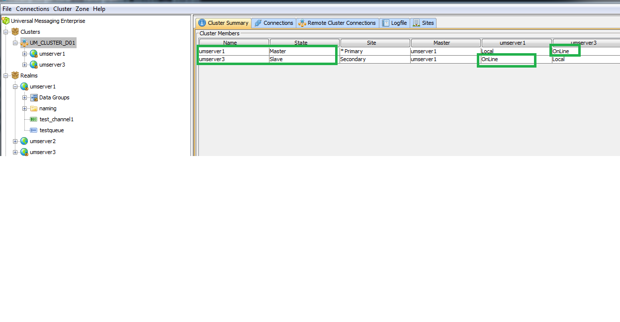

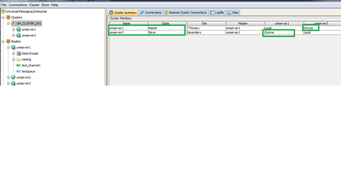

    As part of differentiating the set up , I have tried to create another real instance on the same node where umserver1 realm server was created . The realm server ,umserver3 was created with different port (9010).
    After that I modified the cluster by taking out umserver2 and bringing umserver3 (hosted on same node as umserver1 created). The master/slave state is showing with other node as online . The attachment is there for the same . However on creation of one channel in umserver1 did not got reflected in umserver3. This is failure of successful cluster. Although the cluster summary page shows proper master/slave and all status as expected .

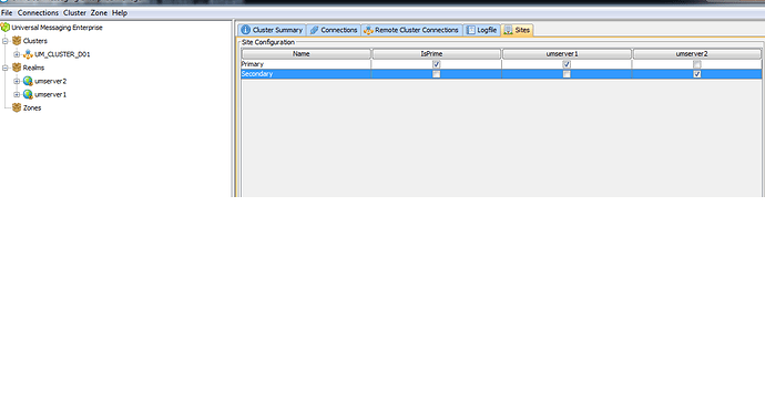

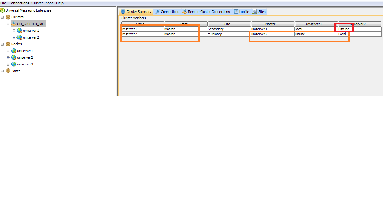

    After this I reverted the node cluster with different host as previous implantation. This time I deleted the sited and recreated by giving the Primary to umserver2 (Earlier case umserver1 was set Primary) and voted IsPrime.
    The cluster summary page shows strange message as both Master . Screen shot attached . However , the above log message stopped coming .

    However , my implementation method of the cluster is using site concept which overrides the quorum requirement
    (availability of more than 50% of the servers), and the cluster can operate with only 50%
    active members.
    The cluster with two sites (primary site and secondary site) and configures with setting the IsPrime flag in the primary site. In this case, the primary site with the IsPrime flag gets an extra vote.
    The weird part is that one one node other offline but other says its disconnected . later reversing the IsPrime flag the message changed but still other node says offline .
