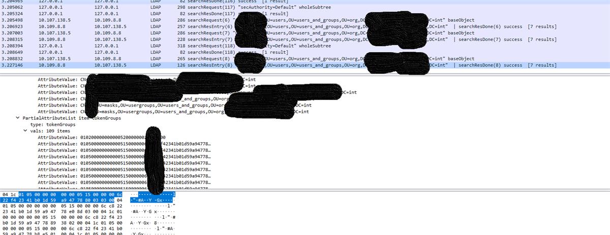

    However, debugging the STSUU object clearly showed that these groups were not added to the STSUU. I did a packet trace on the non-SSL enabled LDAP calls between ISAM and our AD during authentication, and ISAM does fetch the tokenGroups attributes as shown in the picture below:
    So somehow the tokenGroups attributes (which are binary SID values) are sent to ISAM, but it seems ISAM throws them away since it does not know what to do with these strange values.
