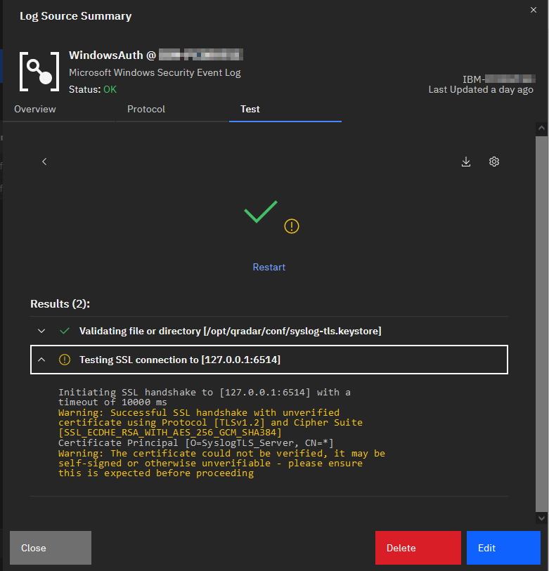

I created my log source first, then did a deploy. Then I setup WinCollect and did not receive any connection errors. After I restarted WinCollect using the contents of syslog.tls.cert in my destination, I received events after the service restart.
The default self-signed cert that is packaged with QRadar is syslog.tls.cert. I had a typo and missed cleaning up the filename in my steps. You can open the syslog.tls.cert file in a text editor and add it as a destination on your WinCollect agent. I walked through these steps and set up a TLS log source on a new VM install and I was able to receive TLS 1.2 events from my laptop, which points to an EC in our support lab. Be aware, as the default syslog.tls.cert file is self-signed, when you click TEST, it will give you a warning. This is expected as the default cert is self-signed.
For example, I expect this error when I test the log source as the syslog.tls.cert file is self-signed I used in the log source. I blurred by hostnames, but am receiving events from WC 10.1.6 --> EC VM in our lab.
If you are having issues with you log source, you can always open a case. We have a team of support representatives who can confirm your configuration.
