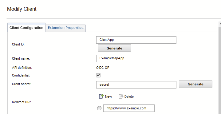

    The OpenID configuration, on the Grant Type I only selected Authorization code.
    The OIDC client is configured this way:
