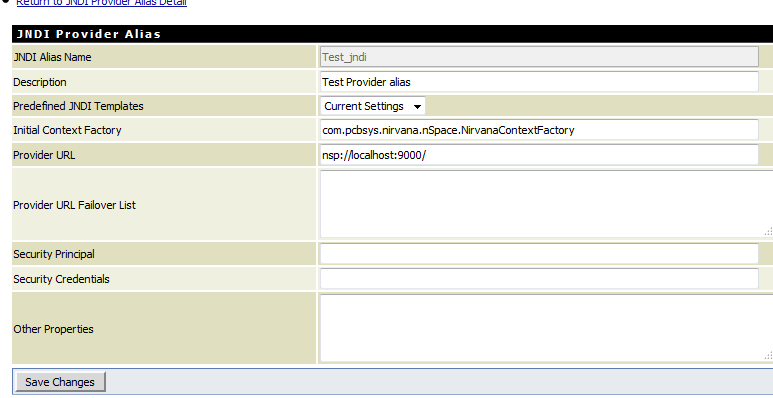

    Hi All,
    I’m trying to create a JNDI Provider alias in wM IS 9.8 below are the values passed
    JNDI Alias Name : Test_JNDI
    Description :Test Provider alias
    Predefined JNDI Templates : (selecting UM) but is set to Current Settings while saving
    Initial Context Factory : com.pcbsys.nirvana.nSpace.NirvanaContextFactory
    Provider URL : Realm server address
    Provider URL Failover List -
    Security Principal -
    Security Credentials -
    Other Properties -
    While trying to do a test look up it fails with the following message .
    Error : Test lookup failed for primary JNDI provider URL “nsp://xx.xx.xx.x:9000/”: JNDI setup failed on RNAME=nsp://xx.xx.xx.x:9000/ .
    below jars were copied into IntegrationServer\lib\jars directory from UniversalMessaging\lib and IS was restarted
    nJMS.jar; nClient.jar; nJ2EE.jar; nP2P.jar; nAdminAPI.jar; nAdminXMLAPI.jar .
    Does the Predefined JNDI template selection got to do anything with this error . Is any other configuration to be for connecting UM and IS . Please suggest.

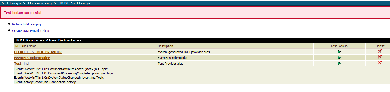

    I have created a JNDI Provider alias in wM IS 9.8 as you did and copied all jar into IntegrationServer\lib\jars directory from UniversalMessaging\lib. Here IS was down so I did make it up.
    I have tested look up successfully. Kindly refer attached screenshot. Make sure your UM is up and running and don’t think any other configuration to needed to connect UM and IS.
    Could you try once from starting and hope it will work.
