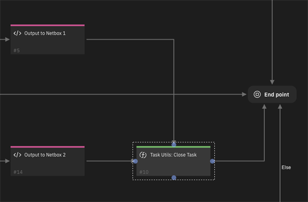

    I think your solution not for my case. My issue is I have a playbook and this playbook has a few threads. All those threads can be or can not be (this is why I can't use "Wait point" decision points) and I faced with an issue:
    Error status
    An error occurred while processing the action acknowledgement. Additional information: The requested operation could not be completed because of an error in a playbook. Have your System Administrator check the application log for details. Task 10383 has been closed task_name was provided; Searching incident 4835 for first matching task with name 'Task name'

    This is that I have. Two ways came to one function - Close Task. Each way can close the task and if no way came here (it possible) - I want to don't close the task. If one way close the task and another way try to do it again - I got an error. I need to check is the task was close before or not and if the task was closed - go to the End point without an attempt to close the task.
