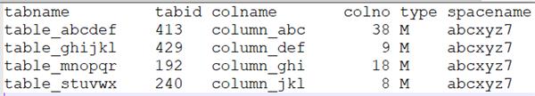

    My current client has a fair number of tables with text and binary blob columns.  However, no blob spaces; all blob column are in the TBLspace with the row.  (Of course on pages separate from the row.)  So I got curious about the way they are tracked and I ran this query:
    select t.tabname[1,18], b.tabid, c.colname[1,18], b.colno,
            b.type, b.spacename[1,10]
      from sysblobs b, systables t, syscolumns c
     where b.tabid = t.tabid
       and b.colno = c.colno
       and t.tabid = c.tabid
     order by tabname, colname
    Here is a partial result of the above, with names changed:
    Some blob columns
    Now, the system catalogs sysfragments and sysdirectives have 3 blob columns each and all the values for column spacename are null.  This makes sense because, of course, there was no blobspace designation when the catalog was created.  But all of the user-level blob columns are the same way - in TBLspace, as I mentioned above - are listed in the same DBspace, named abcxyz7.  (Name changed to avoid concerns of confidentiality.) That  DBspace exists but none of the tables returned by my query have any partitions in abcxyz7.  This value should also be null for these tables!
