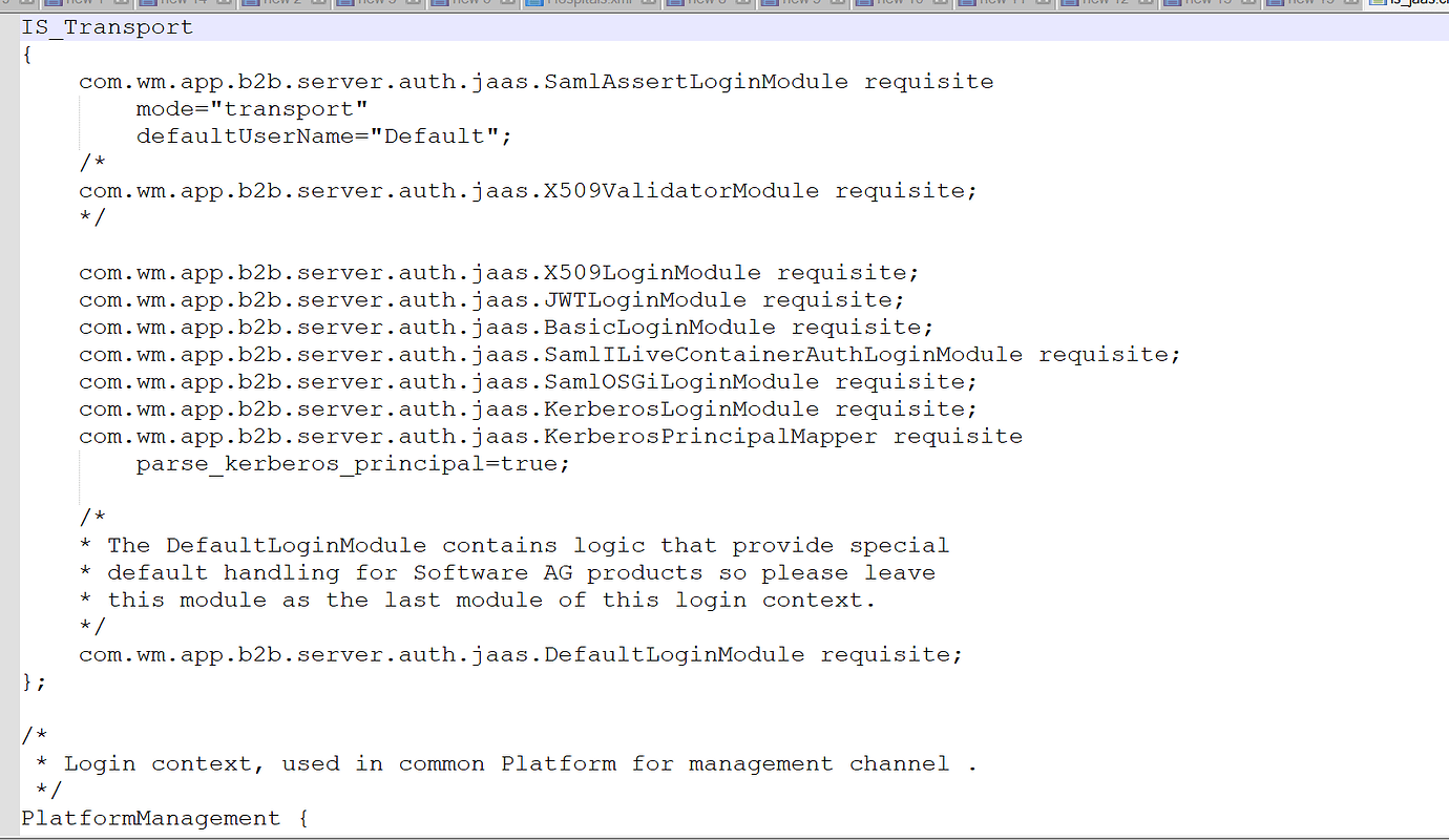

We have restarted the server , after the restart Admin credentials are not working. LDAP is not configured for this server, only Administrator credentials . Can you please assist
2023-09-27 00:39:22 PDT [ISS.0012.0012W] (tid=896) Authentication of user “Administrator” failed with exception: No LoginModule found for com.kmv.ist.b2b.cs.login.kmvB2BDSLoginModule. 2023-09-27 00:39:22 PDT [ISS.0053.0002C] (tid=896) Access denied for user Administrator on port 19190 → ‘wm-message’ from (IP address)
Check your IS JAAS Module. seems like someone modified it. I would recommend to remove the m.kmv.ist.b2b.cs.login.kmvB2BDSLoginModule and it would work.
I removed that module, its worked. Thank you so much
