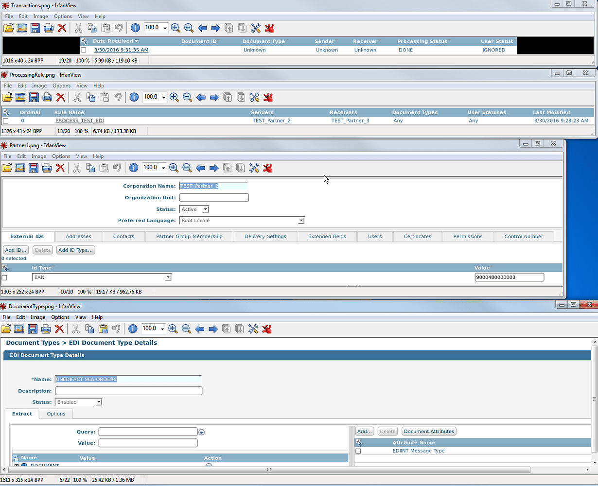

I submit documents through Submit Documents screen in B2B Settings. I use Upload FIle and EDI options with PRT ignore set to true (otherwise it fails with some DB error).
Because it worked for you I decided to start from scratch on a new virtual machine.
Did the same things:
- Added two TPs with EAN codes
Added D96A edifact message
Created processing rule for these trading partners + D96A message → show message in a server log.
Did not create a TPA (there is a default EDITPA)

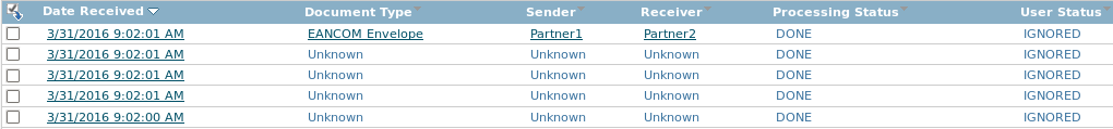

What I get now is that the message is recognized like this - screenshot attached.
So, from here I have a few questions:
- Why is it recognized only as EANCOM Envelope? I expected it to recognize exact message - D96A because I added this DocType. I know that for custom doc types Identifying Query should be setup for recognition, but my understanding is that EDI is supported with built-in functionality if required packages are installed (they are).
- Why there are four other transactions before “EANCOM Envelope” as a result of submitting the file?
I tried to move up my specific processing rule for this case, but it did not help.
