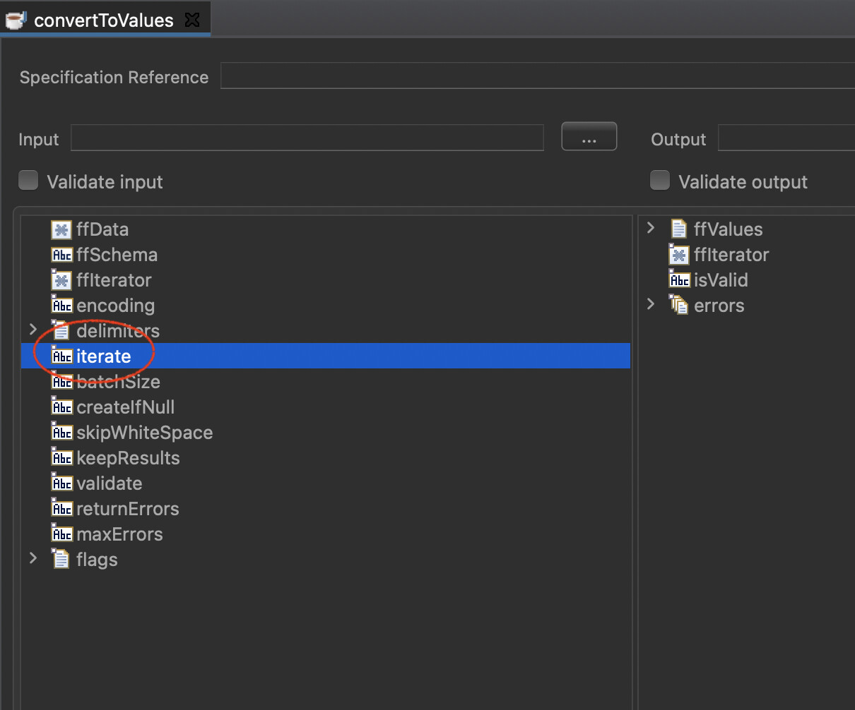

    Do not use streamToString, it will not scale for this use case. You need to iterate over the stream, record by record. You could in fact use the flat file service “pub.flatFile:convertToValues”, which allows for iteration, that way you do not have to have the entire file in memory at the same time e.g.
    Just make sure not to add the resulting records to an array, instead process them immediately and then drop them.

    Hi, John, thank you for your reply.Iterate a stream work fine for me. Now I’d like to do the thing with child thread via a publish/subscribe, could you give more information about that, pls?
    This is my flow:
    -getFile /flow service to get the file to process in stream)
    -REPEAT
    –convertToValues (iterate = true, batcSize = 20000)
    –loop over results
    —map to inputList for batch insert adapter input
    –adapterBatchInsert
    –BRANCH over ffiterator to exit loop in case of null value
