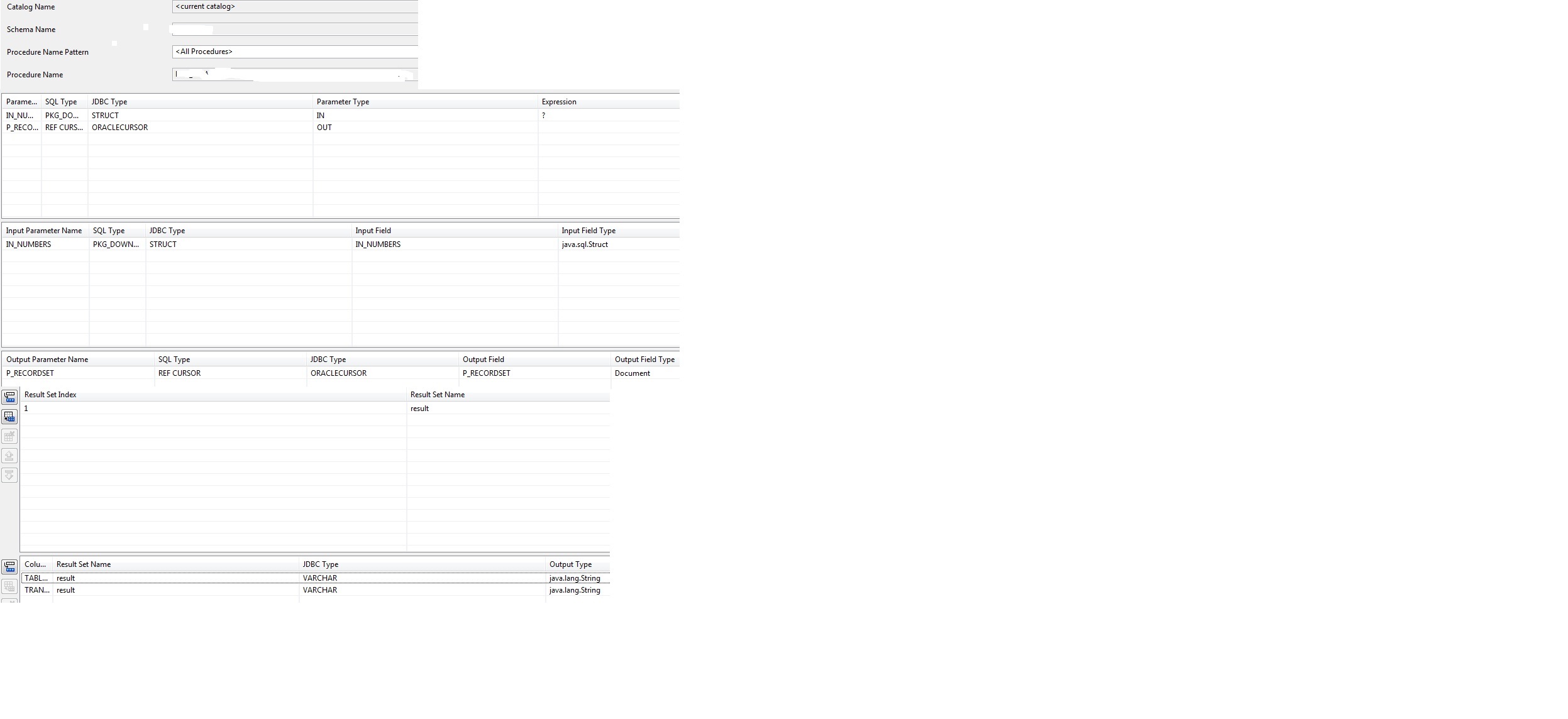

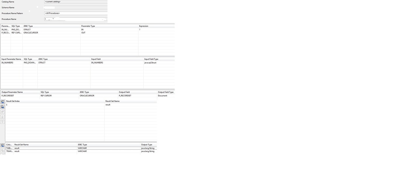

    We have to pass input as STRUCT type to call SP
    com.wm.pkg.art.error.DetailedServiceException: [ART.117.4002] Adapter Runtime (Adapter Service): Unable to invoke adapter service
    [ADA.1.316] Cannot execute the SQL statement “call
    SCHEMA.PKG.P_NUMS( ?, ?)”. "
    (99999/17074) invalid name pattern: SCHEMA.PKG"
    wM version 9.8
    JDBC Adapter version 9.0
    JDBC Fix- JDBC_9.0_Fix7
    IS fixes: IS_9.8_Core_Pre-QAFix_PIE-40509_v2
    IS_9.8_SPM_Fix1
    IS_9.8_Core_Fix5
    Attached the screen shots of adapter service. Sorry, I had to erase and hide few names in the screen shot.
