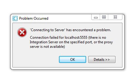

    Hello Team,
    I have installed the webMethods on my laptop, but I didn’t find the startup.bat file inside ‘SoftwareAG\IntegrationServer\bin’ to start the integration server.
    And while launching the Software AG Designer I am getting the error ‘connecting to server has encountered the problem’
    Attached is the screen shot for the same.

    Hi Ankur ,
    If the installation of IS is successfully then please check in this location C:\SoftwareAG\IntegrationServer\instances\default\bin or C:\SoftwareAG\profiles\IS_default\bin

    Thanks Harsh for the reply.
    I found the startup.bat in the below location :
    C:\SoftwareAG\IntegrationServer\instances\IS\bin
    I can able to connect to server now.
