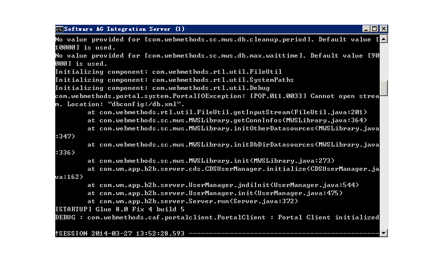

    When I start our webMethods Integration Server,it always encounters the errors which says"Cannot open stream.Location:‘dbconfig:/db.xml’",our webMethods version is 8.2,64 bits,pls advise how to resolve this issue.

  • 2.  RE: start IS encounter errors
    Posted 03/27/14 07:56 AM
    Do you have a MWS installed and configured?
    After the MWS is functional, create a JDBC-pool in IS pointing to the database schema of the IS, assign it to the “Central Users” function, test the pool and the function and restart the function.
    Additionally the IS should be stopped and started over.
    The Error should be gone afterwards.
    HTH.
    Regards,
    Holger
