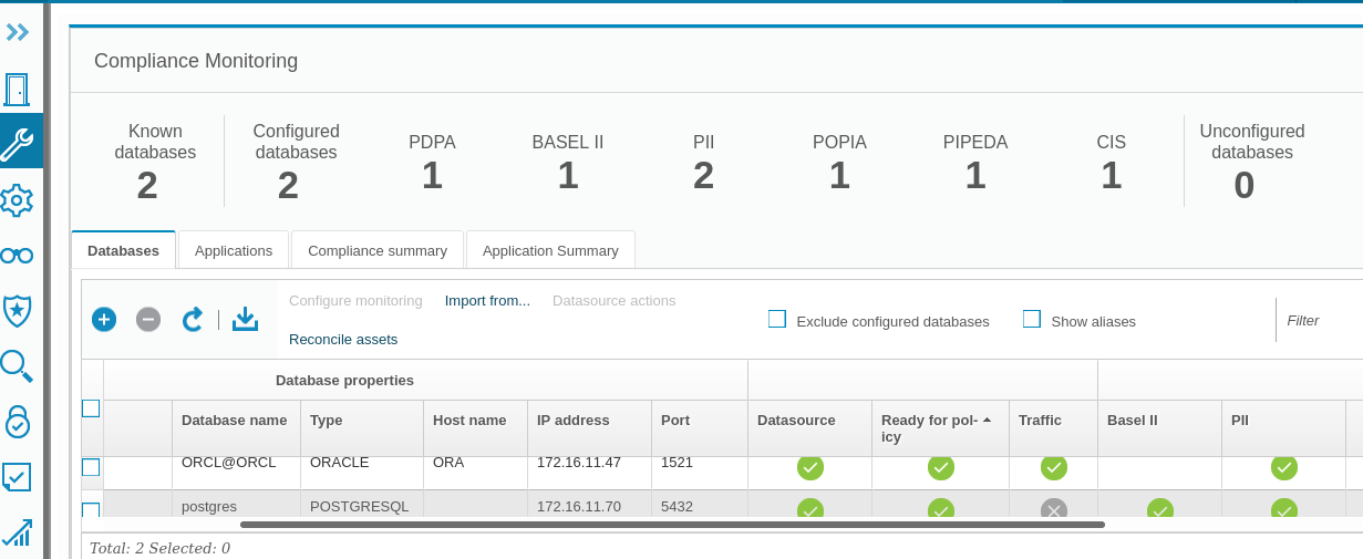

      |   view attached
    We solved the issue by reinstalling all module and bundle : GUIM , STAP , ...
    However, here is another issue related to the same Standalone Guardium appliance :
    We have another DB server with the following :
    DB= postgresql 14
    All KTAP and STAP status is OK now .
    What is the meaning of the Traffic flagged not green as per the screenshot below ? : we got the same with postgresql 10.17 :
    Tsilavo Andriamialison
