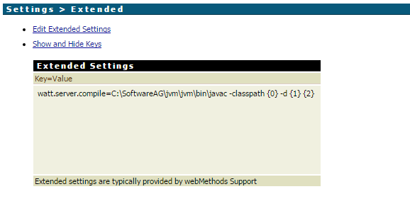

    Could you please share the watt settings related to CORS that you have enabled on IS extended settings please?

  • 3.  RE: [SOLVED] Calling REST Service with Javascript
    Posted Thu May 05, 2016 07:02 AM
  • 4.  RE: [SOLVED] Calling REST Service with Javascript
    Posted Thu May 05, 2016 07:12 AM
    Sorry. The screenshot does not show any CORS related watt settings. Could you please unhide them and then share the details please?

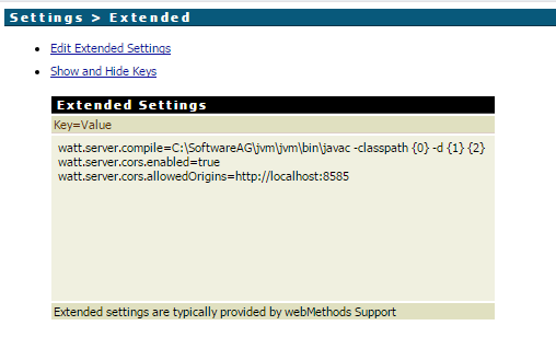

    HI,
    I have the same problem. I try to call a service with javascript. Because the website is on port 8585 and the service is on port 5555, the browser says:
    XMLHttpRequest cannot load http://localhost:5555/rest/votingMachine/restServices/saveData?json=… Response to preflight request doesn’t pass access control check: No ‘Access-Control-Allow-Origin’ header is present on the requested resource. Origin ‘http://localhost:8585’ is therefore not allowed access. The response had HTTP status code 403.
    I tried to add
    watt.server.cors.enabled=true
    watt.server.cors.allowedOrigins=http://localhost:8585
    llike mentioned in previous posts, but it is still not working. Is there anything else, I have to configure first?

  • 8.  RE: [SOLVED] Calling REST Service with Javascript
    Posted Thu May 04, 2017 09:58 AM
    Try these:

  • 9.  RE: [SOLVED] Calling REST Service with Javascript
