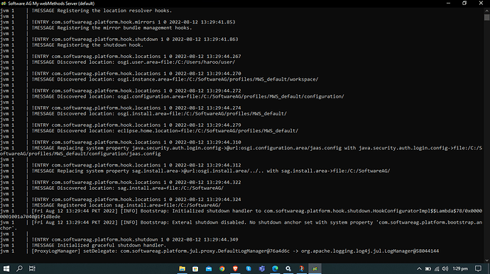

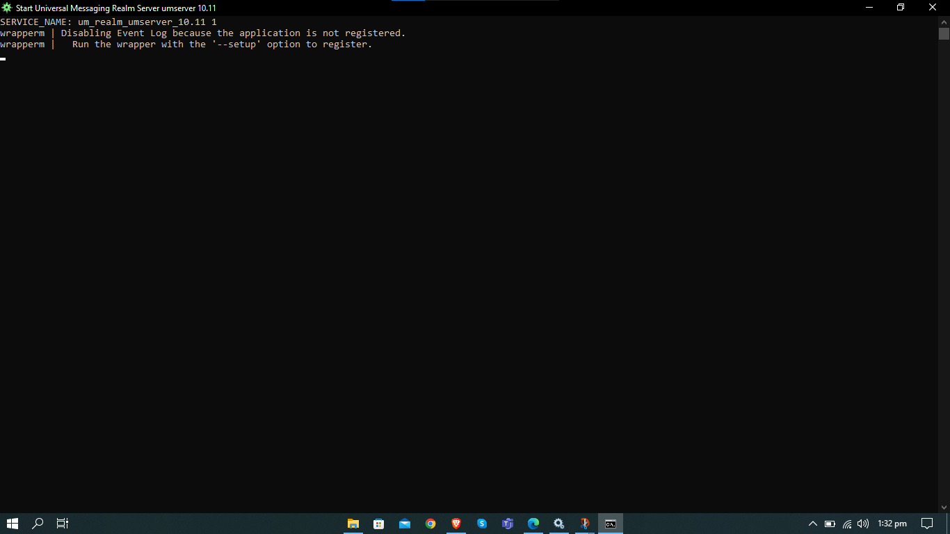

    Hi!
    My Software AG My webMethods Server and Software AG Universal Messaging.
    In Windows OS Services all the above-mentioned services are running.
    When I start Software AG My webMethods Server from the WINDOWS tab or Start, JVM commands run in cmd for some time and then disappears.
    Meanwhile, Software AG Integration Server is running smoothly.
    Screenshots of the above-mentioned problems.
    When I start Software AG My webMethods Server from the WINDOWS tab.
    When I start Software AG Universal Messaging Realm Server from WINDOWS Tab:
    Please help me to solve these problems.

    Hi,
    when the services are already running there is no need to start them manually from the Start menu.
    Additionally I cannot see any error messages in your screenshots.
    Can you check the MWS/server/default/logs/_full_.log for further informations.
    UM should have some log files at similar locations.
    If this is not what you were looking for, please provide more detailed description why you think your instances are not starting correctly.
