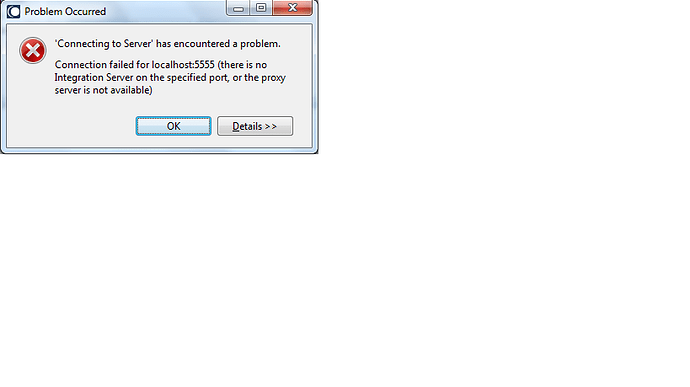

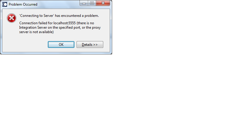

    @rmg I’ve tried that and it still doesn’t work. I even tried creating a new connection and that gives the same error. I just don’t have time to look at it at this point.
    Connection failed for localhost:5555 ([ISC.0064.9324] Server Error: Service Unavailable)

    Are you sure is it localhost:5555 accessible from the network/browser?
    Can you try IP or server name with port?

    A couple of things. The issue with designer was that the network connection was set to Native and needed to be direct.

    Hi All,
     When I try to connect with integration server it shows the connection refused error. Help me to resolve this issue
    Thanks.
    #Integration-Server-and-ESB
    #webMethods
  • 14.  RE: Simple Tutorial
    Posted 09/09/15 08:05 AM
    Hi Preethi,
    what are your proxy settings (Window → Preferences)?
    Can you try to use the real name of your pc instead of localhost?
    Regards,
    Holger
    #webMethods
  • 15.  RE: Simple Tutorial
    Posted 09/09/15 10:04 AM
    For me it looks like you have changed the default port of IS i.e, 5555 during installation.
    Connect with the correct port and retry.
    #webMethods
  • 16.  RE: Simple Tutorial
    Posted 09/10/15 10:27 AM
    Hi,
     Thank you Holger von Thomsen and M@he$h. The problem was resolved. Actually the problem was because of HOST. Need to put actual host name there.
    ThAnK YoU

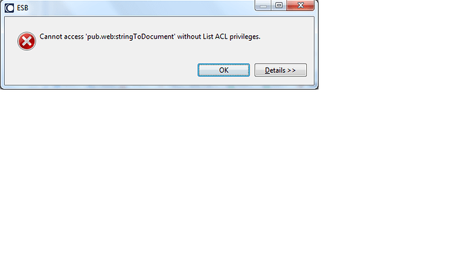

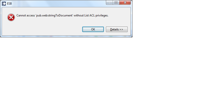

    Hello All,
          I have one requirement to convert bytes to Document. For that I planed to use bytesToString and stringToDocument services. Actually an issue stringToDocument. When I try to include it in my service it shows below error message
    #webMethods
  • 18.  RE: Simple Tutorial
    Posted 10/01/15 08:09 AM
    You do not have the List ACL privileges and I do not find any information on the BIS guide.
    Use pub.document:bytesToDocument
    Any questions?
