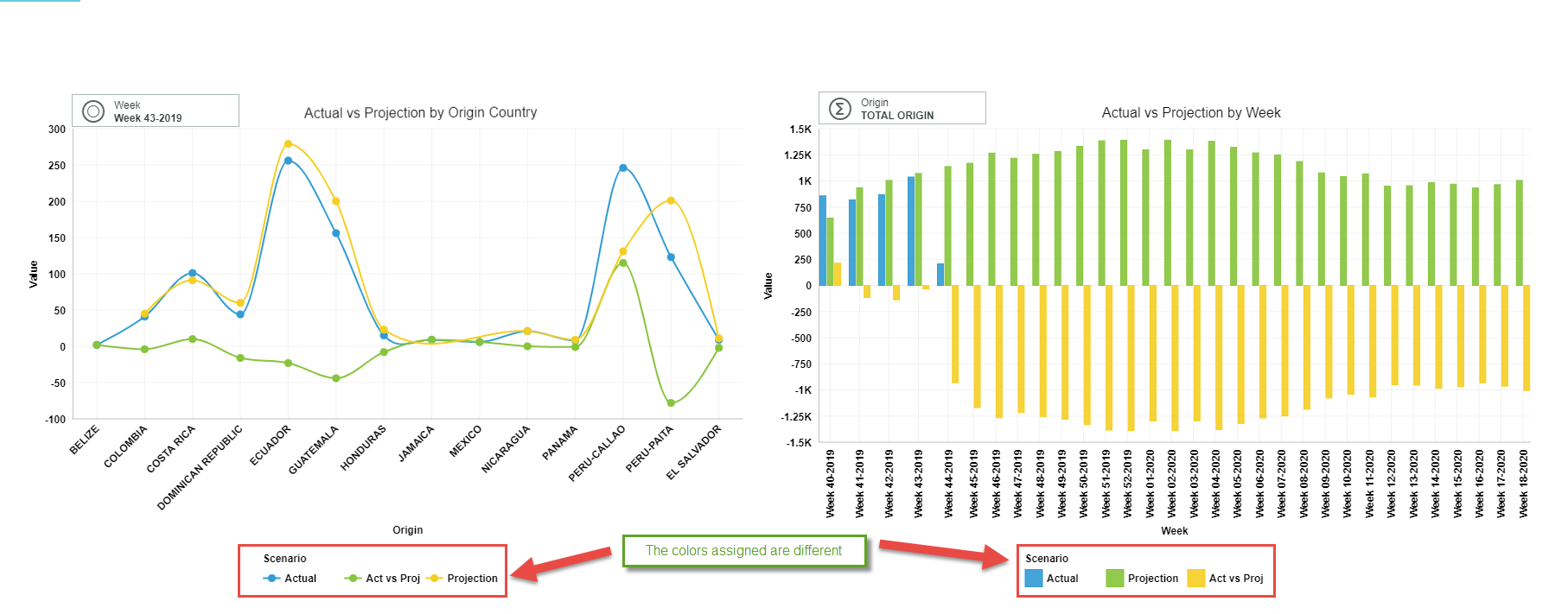

    Hello,
    i built a report in paw with two graphs (one line graph and the other is a bar chart), both visualizations use the same measures but one is for country and the other is by week.  The issue that i'm having is that the color assigned to the measures are different between the two viz and i want them to have the same color in both, is there a way to make it happen?
    Thanks

    Hello,
    Colors in graphs are assigned using the order of elements (here the scenarii) displayed in the subset. If you set in your second graph the same order than the first one, it should solve your problem.
