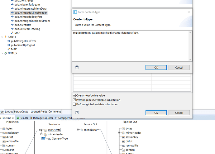

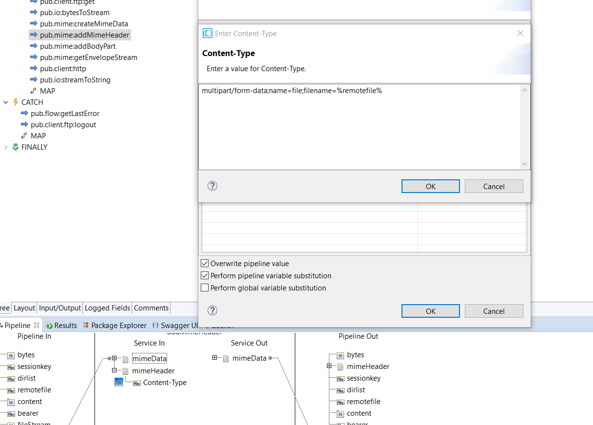

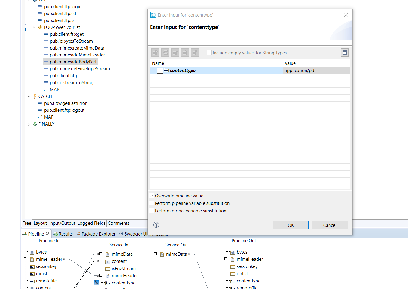

    Hi I also check that post and it couldn’t help my solution because he only describe how to send json format. I could not achieve to send pdf. I am getting 415 unsupported media type error from the server . Here is what I try ;
    On server side, Developer told me that it needs to be multipart/form-data as content type, but I send application/pdf, but when I try to send multipart/form-data on http header content-type it gets 400 error directly.
    And when I try to change contenttype on addbodypart method it gives an error like
    “MIME part of type “multipart/form-data” contains object of type java.io.ByteArrayInputStream instead of MimeMultipart”

    Now I changed the contentType in http header as multipart/form-data; boundary=--------------------------TEST
    It gets
    “{”$id":“1”,“message”:“Unexpected end of MIME multipart stream. MIME multipart message is not complete.”,“type”:“System.IO.IOException”,“date”:“2021-10-22T07:57:56.706142Z”}"

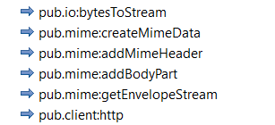

    You’re on the right track. You create the multipart/form-data with the steps in your screen shot.
    createMimeData -- set subType = form-data
    You likely do not need to call addMimeHeader -- what are the inputs being set?
    addBodyPart -- for the file; set these:
    content - the stream of the file content
    isEnvStream - no
    mimeHeader -
    Content-Disposition = form-data; name="upload" filename="%/yourVarWithFilenameNoPath%"
    contenttype - application/octet-stream; name="%/yourVarWithFilenameNoPath%" -- might specify application/pdf instead
    encoding - binary
    getEnvelopeStream -- set createMultipart = yes
    http -- Nothing special needed here, just map the envStream to data/mimeStream; you could set Transfer-Encoding to chunked for efficiency
