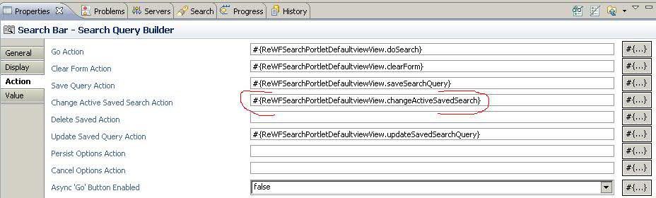

    I have a question about the “Change Active Saved Search Action” functionality of the “Search Bar” component.
    When exactly is this functionality executed while using the Search Bar?
    We have created a method and configured the Search Bar component to used it as can be seen in the screen shot.
    While testing, we have found that the method is executed only when switching between saved searches on the Saved tab. Is this the normal/full functionality?
    Shouldn’t this method be executed also when switching between the Advanced tab and the Saved tab when a saved search (if existing) is also loaded?

    Yes, i think you are correct. When switching the saved search in the drop down on the advanced tab, that method should be invoked.
    Please file a Service Request and reference this thread. In order to get a fix.
