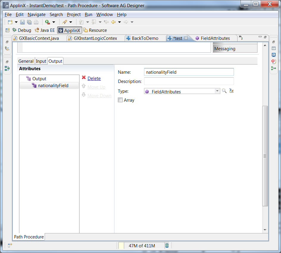

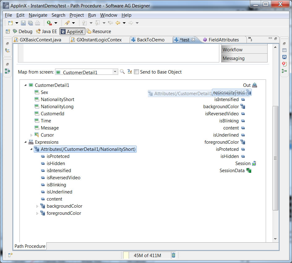

    1. From the Field attribute expression. Highlight all the attributes, right click and select “New Data Structure”. (see newDS.jpg)
    2. Create an output variable fro each desired field. The variable should be a structure of the type you created earlier.(see outputVar.jpg)

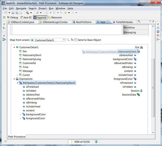

    3. Drag the each field’s attributes expression on to it corresponding variable.(see dragging.jpg)
    4. All the attributes will be automatically mapped.
    While this will not help you avoid creating an output variable and mapping each field. It will help you avoid having to map each attribute of each field.
