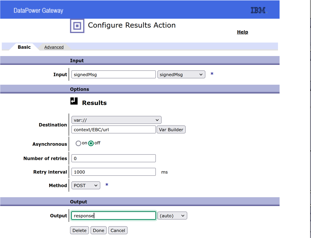

    Keep in mind, scheduled processing rules don't have a client to which to respond.  Therefore, they must operate totally on their own.
    In your case, replace the route action with a results action setting the destination to 'var://context/EBC/url' as in the picture.  Then, follow the results action with whatever actions are needed to handle the response.  I threw in a transform action as an example, because I have no idea what the response looks like or what type of message it is.    See the 2nd image.
    Results Action Configuration
    Using a Transform to process the response
