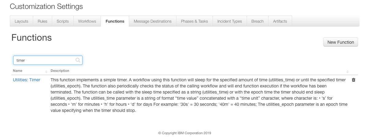

    In fn_utilities v1.0.7 (https://exchange.xforce.ibmcloud.com/hub/extension/2b6699ac8a3976b67dfbddee26dbe3a5) we released a new Function called: Utilities Timer::

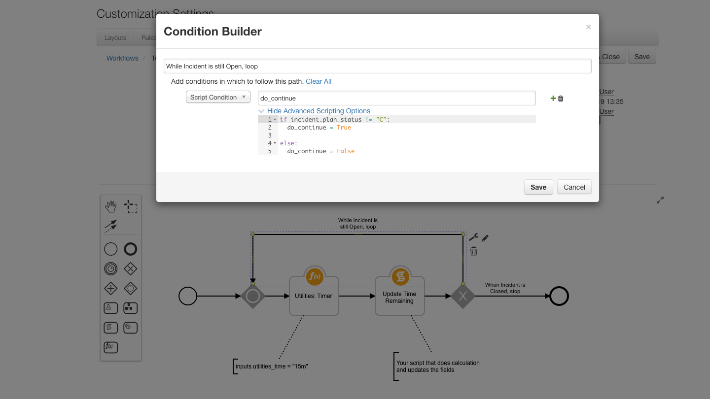

    By combining this Function with your script in a single Workflow like below, I feel you can achieve your use case:
    Above we have set the Utilities Timer to sleep for 15m, after that 15m we call your script that does your time calculations and updates the fields as described in your post
    Then in the Exclusive Gateway that follows the  Script, we have a Script Condition that checks if the Incident is in an Open or Closed State. This condition will end the Workflow if the Incident is in a Closed state:
    And for the other connector for that Exclusive Gateway we have "the opposite condition", that will continue to loop as long as the Incident is not in a Closed state:
    Finally, we would create a Rule that gets invoked on Incident Creation and targets this Workflow:
    This method will start the Workflow on Incident Creation and keep looping every 15m until the Incident is Closed. Hopefully this method of using Timers with Looping in Workflows helps solve your issue...
